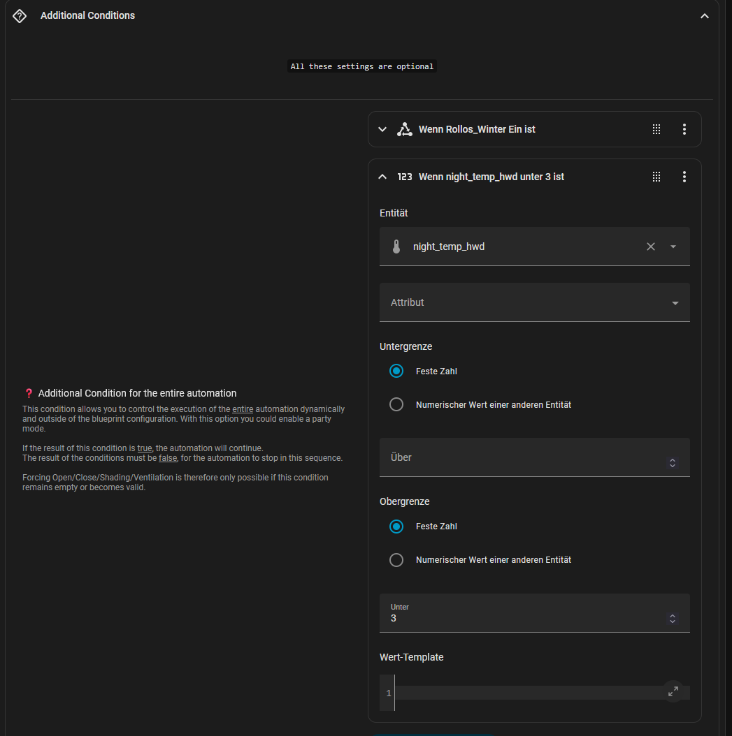

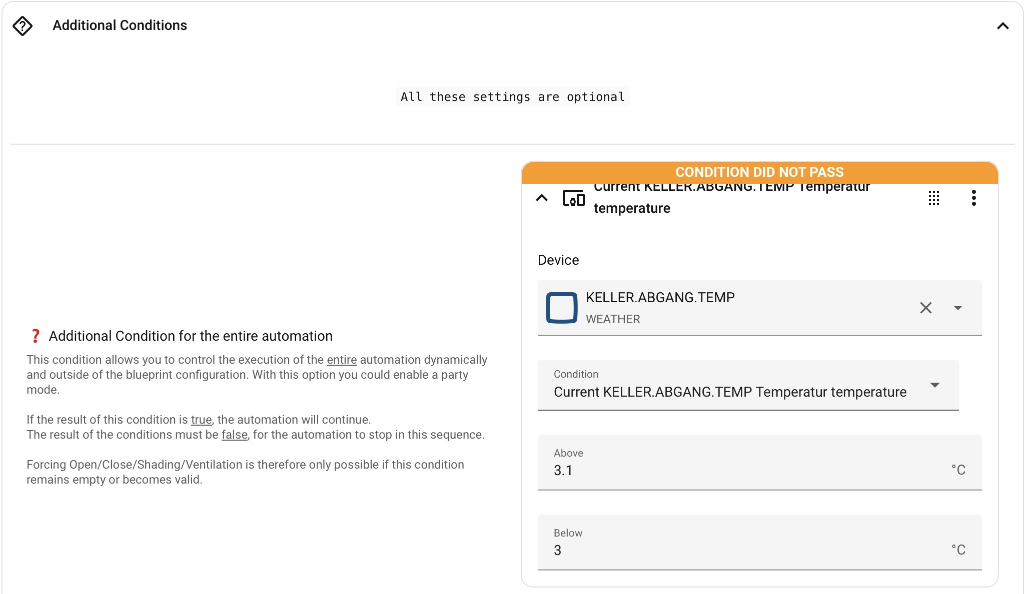

I found these additional conditions but it isn’t as easy as I thought.
Did you have any advice for me how to deal with it?
Cheers Robert
the best would be to have an outdoor temperature sensor. than you can say, if the temp of the external sensor is below x degree stop the automation to move the shutter! If you have no no external sensor it would be possible to add a weather integration and use the temperature from there, but this could be inaccurate!
I allready for an Homematic Outdoor Temperaturen Sensor and also an Netatmo.
Netatmo isn’t working as good as it suppose to. From time to time the base is losing the Wi-Fi connection.
And also the direct HomeKit intergration is loosing the connectivity.
So I would prefer the Homematic temp sensor.
Would you be so kind to explain me how to setup the addional condition.
I all read tried into set it up. But it looks it was not working.
Cheers Robert
Edit:
Screenshot added
you have to use the an numeric entity not the device!
