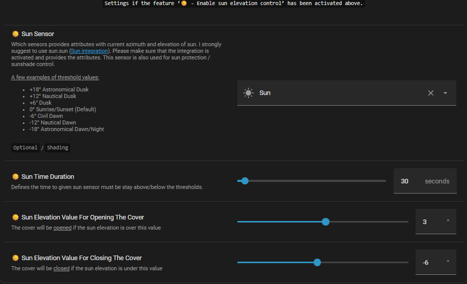

Hi, I have a problem: in the morning the shutters do not open with the automation.
In the evening the automation works.
Is the “Sun Elevation Value for Opening the Cover” not correct? Should I also use the negative value?
Or what could be the problem?

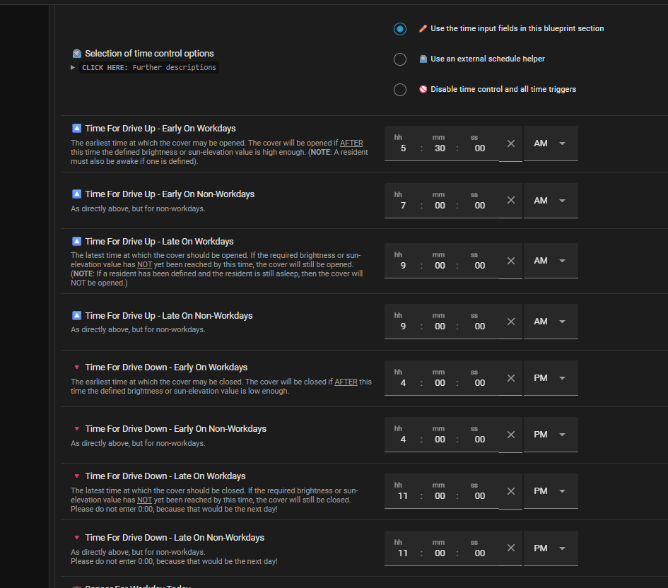

At what time is the 3° elevation reached?
I had a similar issue just to realise that the sun never reached the elevation before the time limit.
the time is according to the localisation +/- 15min if you choose +/-3 sun elevation
So the cover never even open at 9AM ?

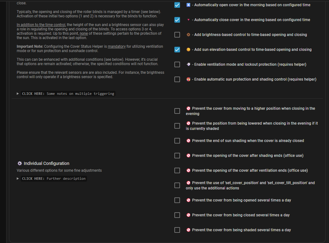

Hello everyone,
I need your help. A few days ago, I switched my roller shutter control from ioBroker (Shuttercontrol plugin) to Home Assistant and this CCA Blueprint. Everything worked perfectly for the first few days. Suddenly, the roller shutters stopped raising. After some configuration adjustments, they’re working again now. However, they no longer lower in the evening.
What I want:
I’d like a schedule for weekdays and weekends/holidays where I can set the earliest and latest possible opening and closing times for the roller shutters. The automation should also take sunrise and sunset into account. That is, if a roller shutter is supposed to raise at 8 a.m., but sunrise is at 6 a.m., the roller shutter should only raise at 8 a.m. Conversely: sunrise at 8 a.m., earliest possible opening time 6 a.m. → roller shutter opens at 8 a.m. – both conditions should be true. The roller shutter should lower itself similarly to how it lowers at sunset. Additionally, I need an automatic forced closing time: If a roller shutter is manually raised again in the evening, it should close automatically after the configured forced closing time.
Separately, I also want to configure the shading of some roller shutters so that they can be set to a specific height depending on the position of the sun and the outside temperature.
Unfortunately, I haven’t been able to implement this configuration yet and currently don’t understand why the automation isn’t working. At least the window/door contacts seem to be taken into account. (Lockout protection)
What have I set up so far?
  • one automation per roller shutter from Blueprint
  • external state helper for each shutter
  • external scheduler
  • Workday sensor
  • Door contacts wrapped as binary sensors

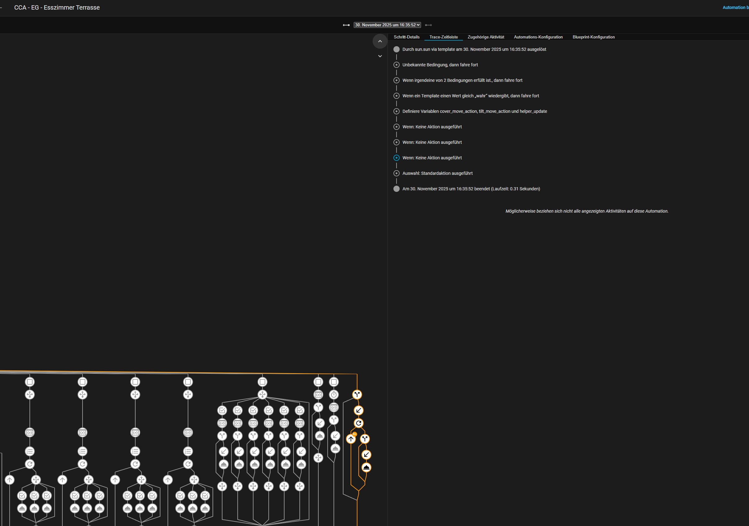

First of all, thank you for the feedback. The shutters didn’t go down again this evening, but therefor they did go up this morning :slight_smile:
Here’s the trace of the event from “Sun.” But I’m still not really getting anywhere with it. How can I figure out exactly what the problem is? ( sorry, I’m new to HA)
Regarding the Scheduler Helper, I used it because I thought it was better. I would also use any calendar integration. As mentioned before, I’m new to Home Assistant and open to any suggestions.
But Maybe the shutters will go down at 18:00 because of " time_down_early"
But then, what exactly is the purpose of using the schedule helper then?
Edit:
No, unfortunately the shutters were not closed at 18:00
