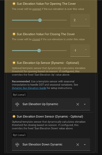

Yep i fully agree, that its good to have only one sensor for up and down. And yes i need a treshold for some automations. But where do i enter the treshold values in the blueprint?
Here. The normal Sun Elevation fields.
The external dynamic sensor only takes over the function of the sun elevation of the sun integration. It’s not that complicated.
Updated: Wrong answer. Sorry.

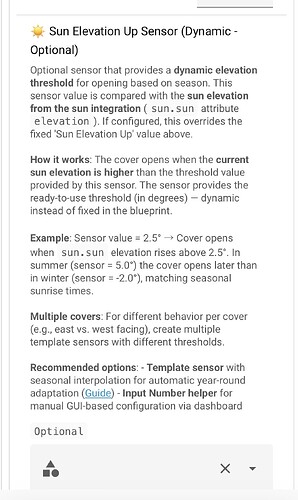

than you have to “correct” the documentation! Nowhere is written that the fixed values will be used as treshold. In the blueprint its written that the values will be overwritten! So in my opinion the wouldn’t be used as treshold!!
Oh dear. I explained that completely wrong. I lost track.
It’s exactly the other way around. The dynamic values replace the input fields in the blueprint. Just like it says in the screenshot.
I’ll go through your questions again soon and answer them.
dont worry…such a thing could be happen in such a big blueprint!..but than think about to use the fixed values as treshold for the dynamic sensors :slight_smile:

I’ve just created your template for the dynamic sun elevation. It now shows 1.9 for UP and -1.1 for DOWN.
However, at -1.1 it’s still bright outside or just starting to get darker.
If I now use the sensors in the automation, as you wrote, they replace the values defined there.
How can I modify the template so that the DOWN sensor shows, for example, -4.0 or -4.5?
Thanks a lot!
actually i have the same “problem” and the only way seems to change the values in the sensor itself. @Herr.Vorragend knows about that and i think he will give us a solution for that:)

The template sensor is an example. The code must be adapted to your situation. You do not have to copy it 1:1.
The customization is described in detail in that file in chapter Customization.
I explained it incorrectly here in the forum. But the description in the blueprint and in the documentation was always correct.
For optimization purposes, I have just updated the blueprint description. In its current form, it is a little clearer.
yep that sounds like it works :slight_smile:
But one Question: To prevent creating several template sensors wouldn’t it be better to use the ignored fixed values in combination with the dynamic ones? I mean the dynamic sensor is especially for my house and if i have 5 of them with different values, the range is everytime the same, only the start of the range differs in each sensor (from the values i set)! So i think the use of the fixed values in the blueprint to move the treshold to the right place would be better than th create several sesnors! Or?

I had actually incorporated delay values that delay the different alignments.
How about we work with an offset like this?
## Using Dynamic Sun Elevation
### Option A: Pure Dynamic (Recommended for identical windows)
- Sensor: `sensor.seasonal_elevation_base`
- Offset: `0`
### Option B: Hybrid Approach (For different orientations)
- Sensor: `sensor.seasonal_elevation_base` (same for all)
- North window offset: `+2°`
- South window offset: `+5°`
- East window offset: `+3°`
### Option C: Fixed Values (Traditional)
- No sensor configured
- Direct fixed value: `5°`
sun_elevation_up:
  name: "☀️ Sun Elevation Value For Opening The Cover"
  description: >-
    **Base threshold OR offset value:**
    - Without dynamic sensor: Fixed elevation threshold (e.g., 5°)
    - With dynamic sensor: Offset added to sensor value (e.g., sensor + 2°)
    **Example:**
    - Dynamic sensor provides: 3° (seasonal base)
    - This offset value: +2°
    - Result: Cover opens at 5° elevation
The sunset and sunrise times are too inaccurate, or rather, it is difficult to fine-tune them. That’s why I decided to use sun elevation as a basis.
Take a look at the description.
yep thats sounds nearly that i tried to explain :slight_smile: !
And the offset in Option B can be set via the normaly “fixed” value in CCA? Or how should CCA knows which cover is north or south?
The old existing static value is then the offset.
