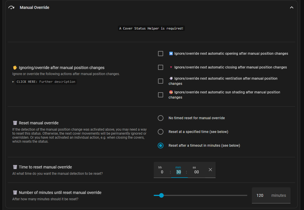

i have a similar problem. Opening the cover manualy. After few minutes i open the door and 8 minutes later i closed the door. Than the cover closes, but it should stay open, because the reset time for manual override is set to 120 minutes!
Today the same.
Could it be that manual override didn’t change the status-helper. On both days i opened the cover manualy and the status of the cover didn’t change to manual = 1!
Hello, same Here. Since update, roller shutter closing after Manual opening and Status helper Not updating Manual.
Chris
I can confirm that. I even have the problem myself. I’ll take a look at it. It probably came about when I enabled external position attributes or sensors.

The status_helper changes the manual part now. But is it normal that the open state wouldn’t be set to 1 if i open the cover?
Example: manual open:
open = 0 → open = 0
close = 1 → close = 0
manual = 0 → manual = 1
I tested it with manual closing and here all status values are correct:
open = 1 → open = 0
close = 0 → close = 1
Mhhh…very curious:
If i open the manual closed cover manual than the status helper is set correctly, i think!
open = 0 → open =1
manual = 1 → manual = 0 ← is this 0 correct?
