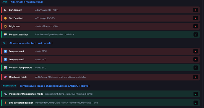

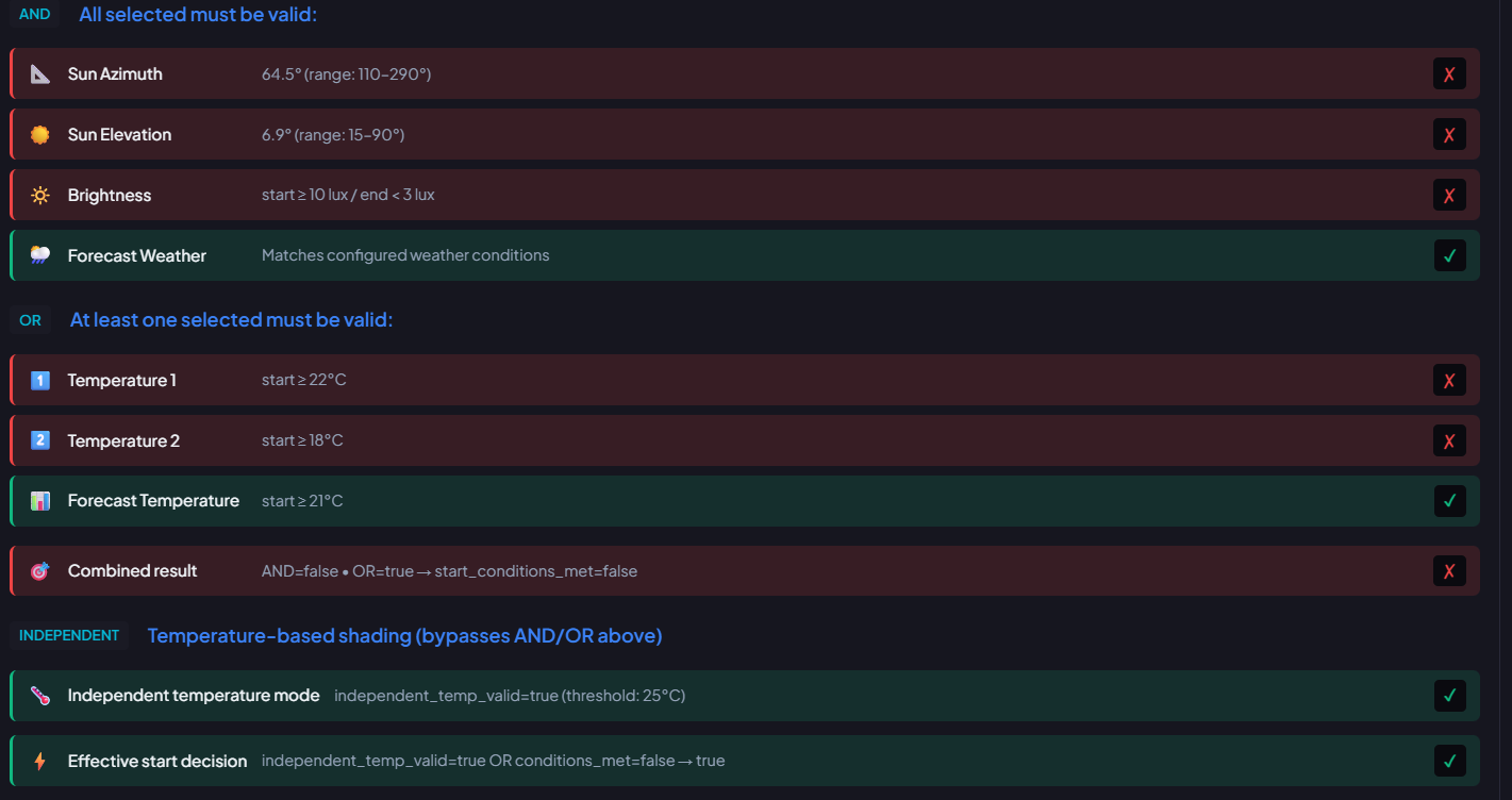

Version 2026.05.30 starts shading in the morning - even with almost none conditions are met:
Regards.
Forecast Temperature is true -> Shading?!
How do I get this view?
TraceAnalayzer CCA Trace Analyzer
How to deactivate?
Even if Forecast Temperature is valid, shading should start only if Azimut is in a valid range.
Does not make sense to start shading, if the sun is not close to the windows.
In that case, you shouldn't use "OR" in the condition; instead, you need to use "AND." Here's how I would try it
I think I have found it. Seems to occur together with the "independent shading" option:
Shading seems to start only if temperatur is triggered - independent from azimut.
For me I do not understand this feature.

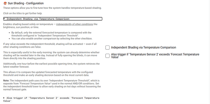

Hi Skol, this is expected behaviour, not a bug β€” and you found the right cause. The "Independent Shading via Temperature Comparison" option is designed to bypass all other conditions, including the sun azimuth and elevation. Its purpose is to decide early β€” from the forecast temperature alone β€” that the day will be hot, and move the blinds straight into the shading position before the sun even reaches the facade. That's why the azimuth (64.5Β°, outside your 110–290Β° range) and the low elevation are ignored in your trace: independent_temp_valid=true short-circuits the whole AND/OR block.
Note that the bypass is not limited to the morning β€” it applies whenever a shading-start trigger fires while the forecast stays above the Independent Temperature Threshold (25 Β°C in your case).
To deactivate: open :hot_face: Sun Shading – Configuration and uncheck "Independent Shading via Temperature Comparison". Shading will then start only when the normal AND/OR conditions β€” including the sun azimuth/elevation β€” are met.
I've clarified the in-app description for the next release so this is obvious up front.
