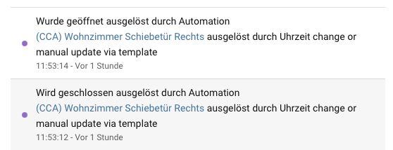

One thing I noticed, from time to time I see that shading is triggered and my two blinds in the living room next to each other are going into shading mode but a few seconds later one of them opens again and then never goes into actual shading position while the helper is showing that shading is active (like it would have actually closed, exactly like the one next to it that actually is in shading position)... no clue what's happening there and unfortunately I don't have a trace for it from today.
Maybe you still know what could trigger this...
