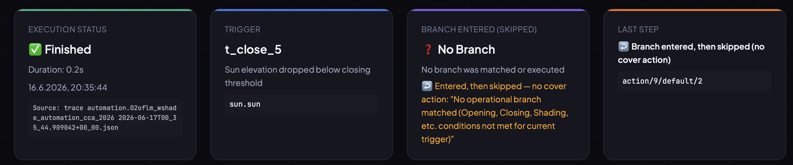

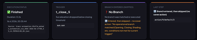

I have setup a simple sun elevation trigger, nothing else and it does not work. I can see it is triggered at the correct time (sunset, sunrise) but nothing happens. The configurator validator gives me no error but the trace analyzer gives me this:
Am I missing something?
Thanks!

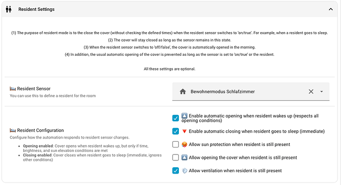

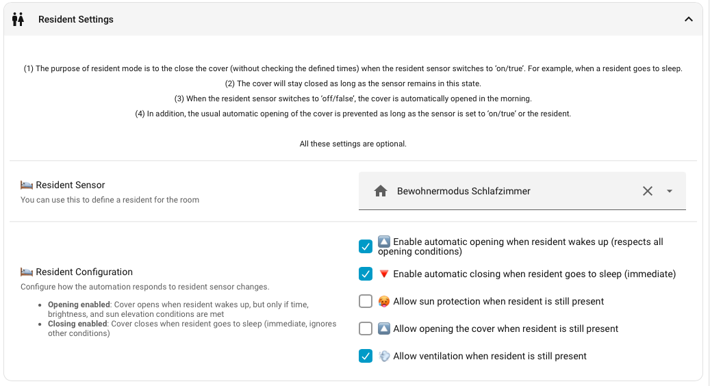

@Herr.Vorragend could it be that there is a bug in CCA 2026.06.16 ?
I have the Option set that shading should not happen while Resident is present but today shading started on all covers while they were still in resident mode...
I saw in the table that shade is on and status is resident but they still moved to shading mode.
Yes, you're right β€” this is a confirmed bug, and it's now fixed (will be in the next release).
What happened: With "Allow sun protection when resident is still present" disabled, the shading intent was correctly stored without moving the cover when the conditions were met during resident presence β€” that's why you saw shade = on and status resident but no movement. However, the separate shading-tilt adjustment (which re-angles the slats as the sun rises) was missing the resident check. So when a tilt trigger fired, it tilted the slats into the shading position anyway β€” making the covers look like they entered shading mode despite the resident being present.
It only affected covers with slat/tilt control (venetian blinds), which is why it hit all of yours.
Fix: The shading-tilt step now respects the resident "allow shading" setting just like every other shading movement.
Thanks for the detailed report β€” shade on + status resident was exactly the clue that pinpointed it. :+1:

Hi, your trigger works fine. t_close_5 firing only means the sun crossed your closing threshold; it doesn't mean the cover will close. The "No Branch matched" in the trace means the closing branch's conditions weren't met.
Key concept: in CCA, sun elevation/brightness are not standalone closing triggers. They're conditions evaluated inside the time window.
Two things to check:
  1. "Automatic Closing" must be enabled in the options. The #1 cause: people set sun thresholds but forget to enable the closing feature itself.
  2. For pure sun control with no schedule, set the time control mode to "disabled". Otherwise the sun threshold only acts within the closing window (default 16:00–22:00). Which is also why a sunrise event never closes.
Tip: enable the logbook option to see trigger.id, effective_state and why no drive happened on each run.
So you're not missing anything on the trigger side. Just the closing feature toggle and/or the time-control setup.
