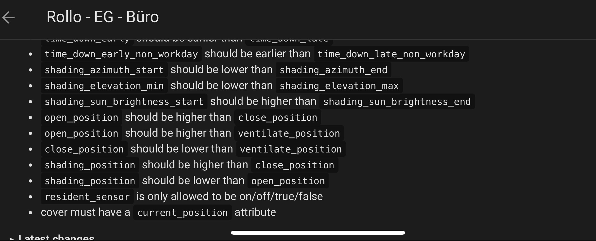

But the biggest problem will be this:
shading_position: 0
This means that the shading position is identical to the close_position. This will not work. Please also note the information under “Position Tolerance”.

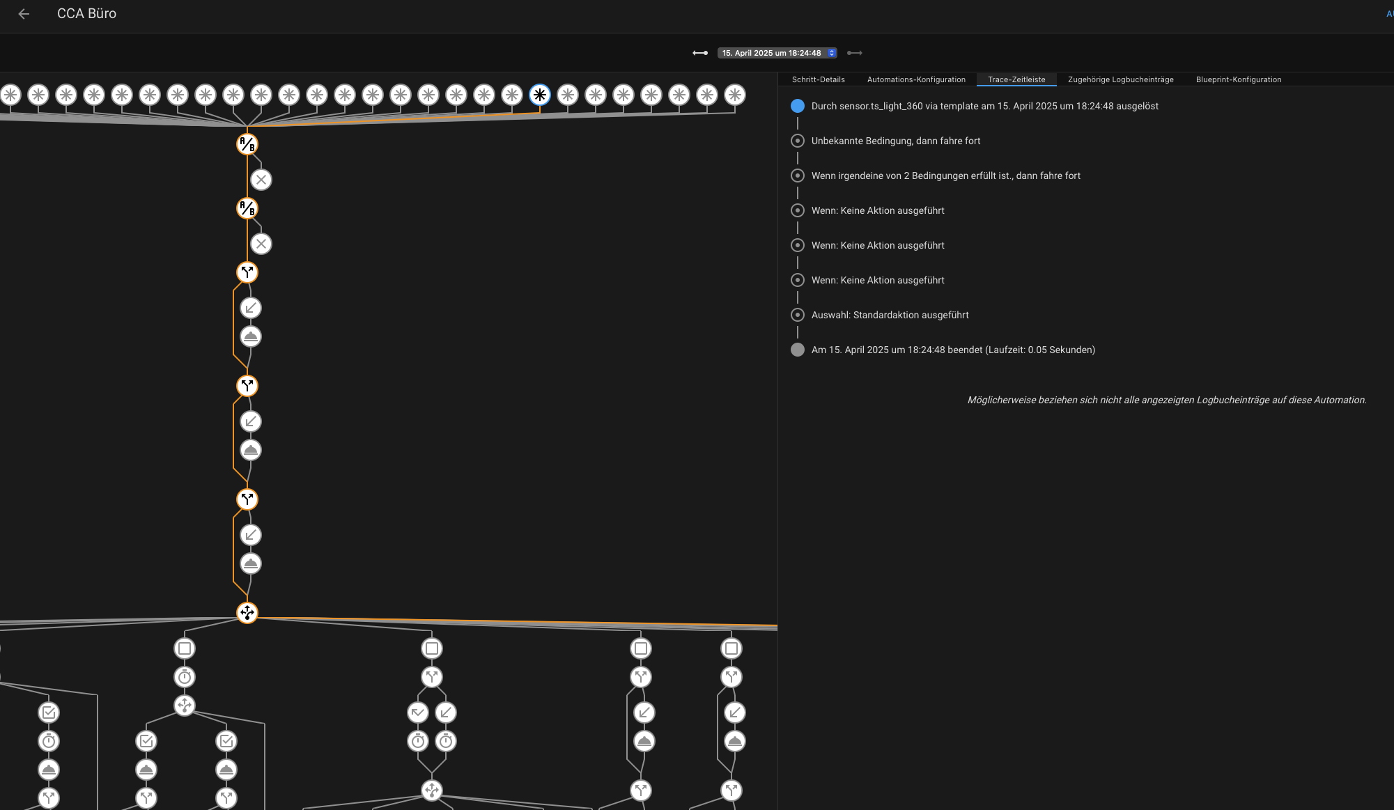

This is a wrong trace. This refers to the detection of the target position. I need the triggering before that.

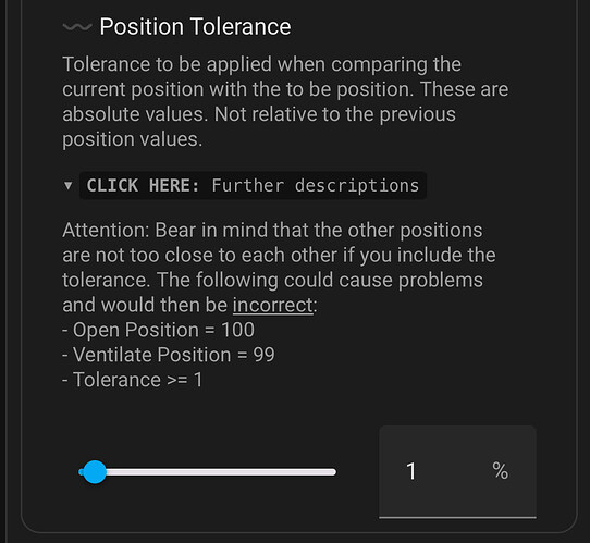

I have set the position tolerance to 4%.

Please search for the affected trigger at the top of the arrows. And then save the JSON (top right).
I look for triggers such as time, threshold reached and so on. Depending on the problem you have.
