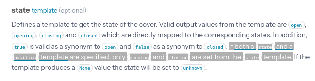

… but the bigger issue is:
https://www.home-assistant.io/integrations/template/#cover
If you want state/value_template to control the the open and closed values you can’t use position/position_template.

Looks like I worked with an outdated version. My interpretation was that the value template is used to define the state and then the position is the more granular information based upon this.
In my automation I don’t care if the cover is 20% or 50% closed, for me it is closed. HA currently sees this as 50% open which is just a different way of intepreting it. So I will update my logic to adjust.
