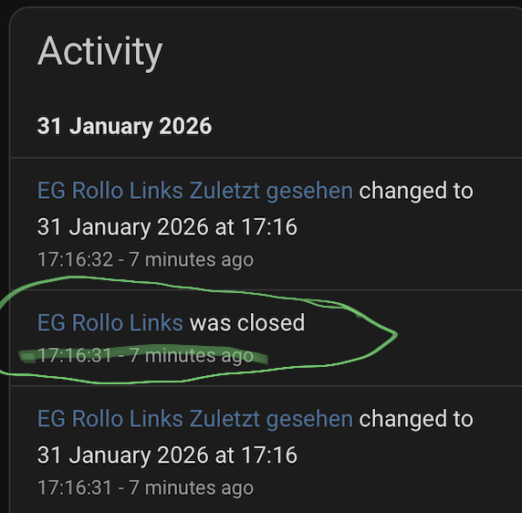

Unfortunatly, the activity-log only shows:
DB Rollo Links was closed
16:56:31 - 29 minutes ago

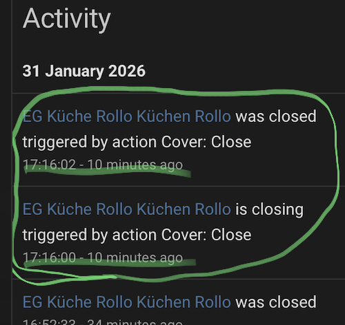

This is all I see:
the shelly shows a little more:

i found it finally as i saw this entry in the Activity-Log:
