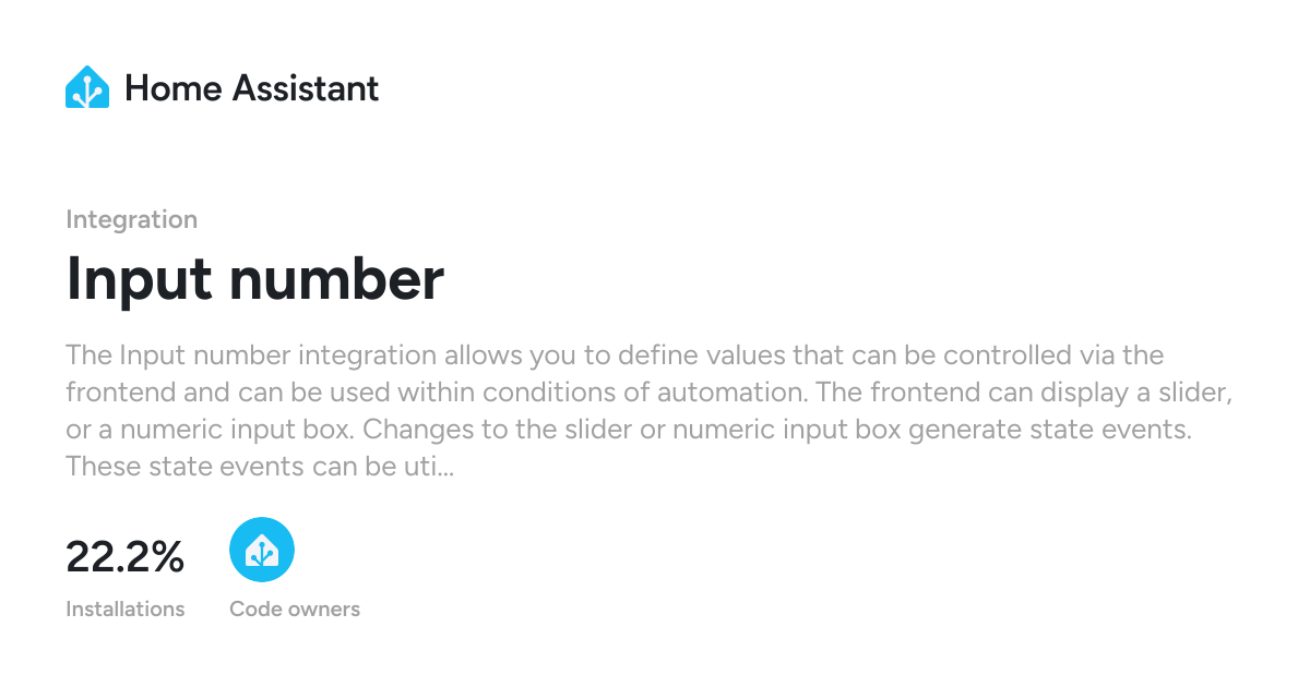

One option is to create an input_number for each parameter, and call for these parameters in the automation. See:
You can then list these input numbers in a separate card, and modify them via the GUI.
