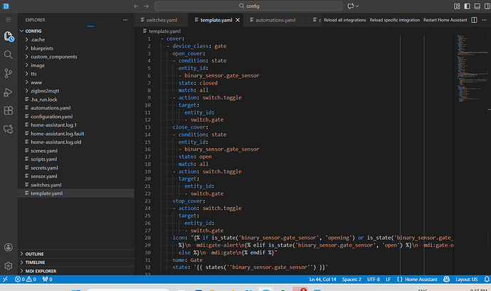

- cover:
  - device_class: garage
    open_cover:
    - condition: state
      entity_id:
      - binary_sensor.garage_sensor
      state: closed
      match: all
    - action: switch.toggle
        entity_id:
        - switch.garage_door
    close_cover:
    - condition: state
      entity_id:
      state: open
      match: all
        entity_id:
    stop_cover:
    - action: switch_toggle
        entity_id:
    default_entity_id: switch.garage_door
    icon: "{% if is_state('binary_sensor.garage_sensor', 'opening') or is_state('binary_sensor.garage_sensor',
      'closing') %}\n  mdi:garage-alert\n{% elif is_state('', 'open')
      %}\n  mdi:garage-open\n{% else %}\n  mdi:garage\n{% endif %}"
    state: '{{ states(''binary_sensor.garage_sensor'') }}'

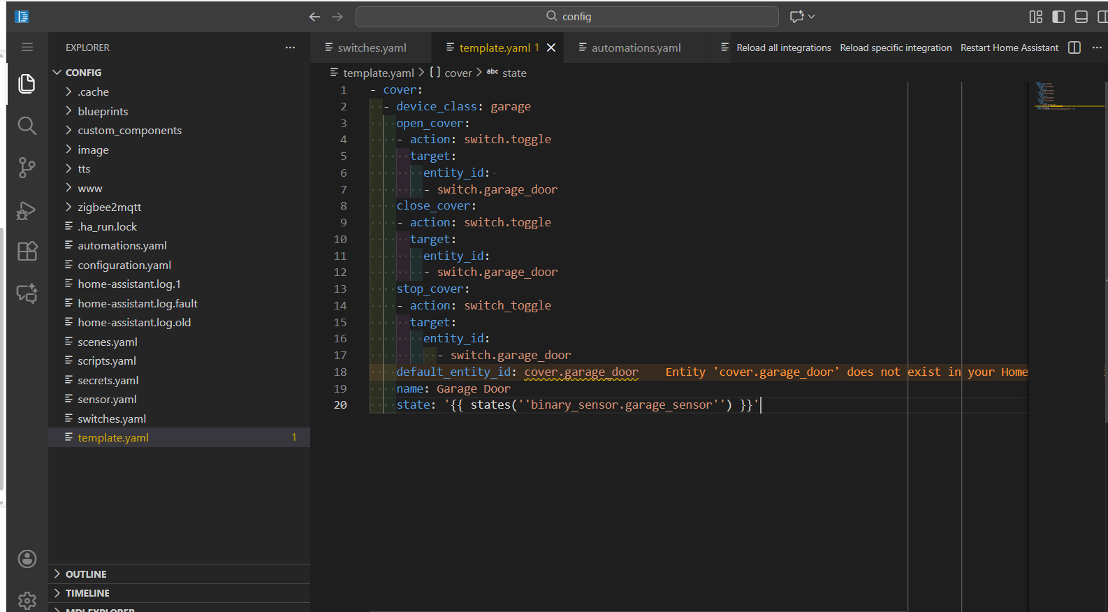

- cover:
    open_cover:
        entity_id:
    close_cover:
        entity_id:
    stop_cover:
        entity_id:
    default_entity_id: cover.garage_door

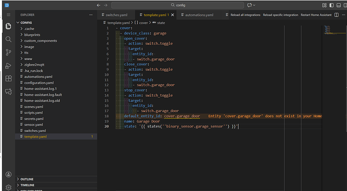

EDIT: And in rewriting your cover, I found your problem. It seems you altered the configuration when copy/pasting this over because the migration wouldn’t have done this. This
should be
There is an error in your logs stating that you incorrectly filled out default_entity_id. Not only that, but the system won’t let you restart with that either.

yes, correct, I had to change it because I got the response
entity_id: cover.garage_door not valid or not found can’t remember
Ignore that. The Home Assistant Config Helper extension for VSCode has not been updated for the new syntax in ages.
You don’t actually need that line anyway. That entity id will be created from the name you have given your cover.
