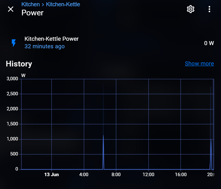

They have power monitoring built in and all of it reads absolutely fine via zigbee 2 mqtt. I have made an integral sensor helper to track this as energy using the left Reimann sum (recommended on another post) but this is creating absolutely crazy energy values.

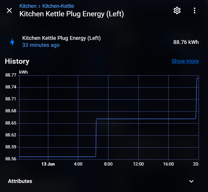

For example today, the kettle was boiled twice at a mean power of 1.1kW. Assuming it boiled for a minute, this would be 0.018kWh. However, my integral believes this to be 88.66kWh.
Now I suspect this is to do with the way in which the integral is calculating the area under the graph, but I’ve also tried the trapezoidal rule to no avail.

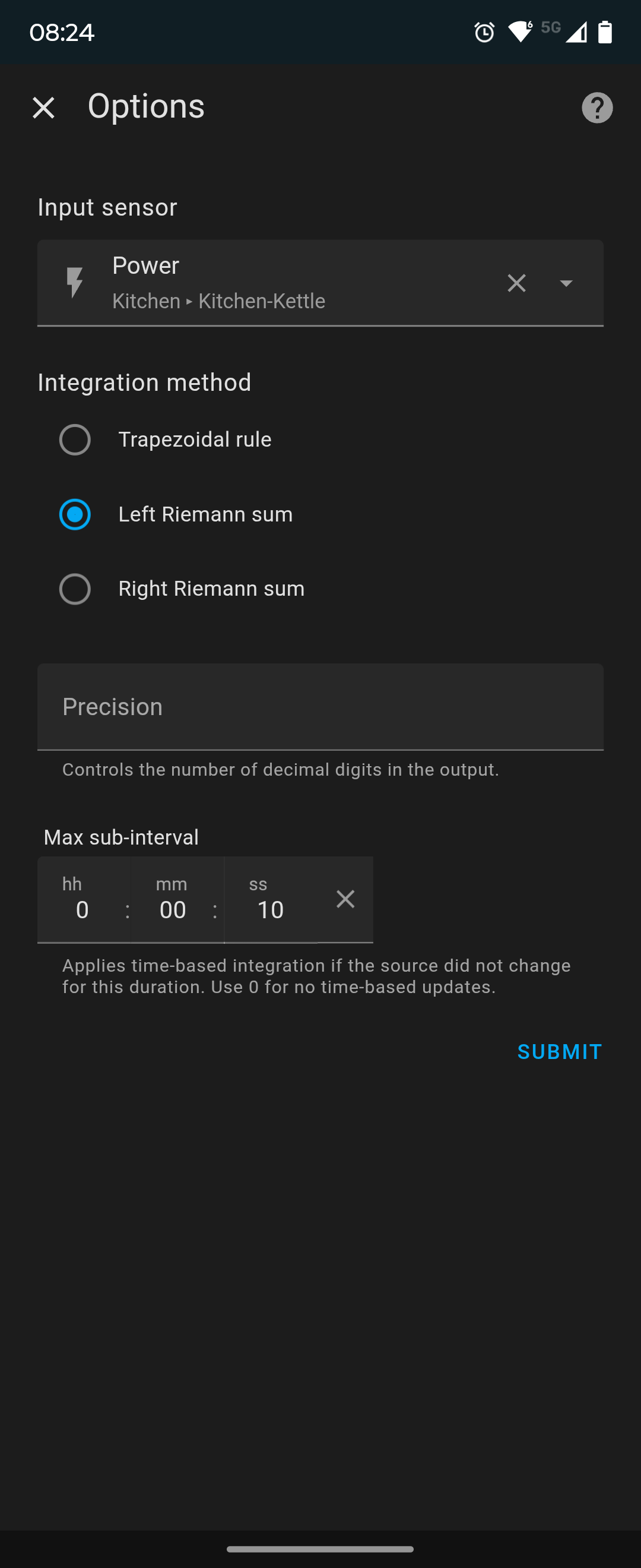

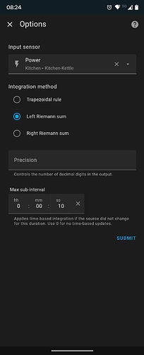

The default integration method is trapezoidal which will cause major approximation errors for that sort of spiky on-off power use.
Use method : left to minimise these approximation errors in the integral helper.
Thanks for the reply but assuming you mean left riemann sum then I am but are still getting these values :disappointed:
Share your Riemann Sum config.

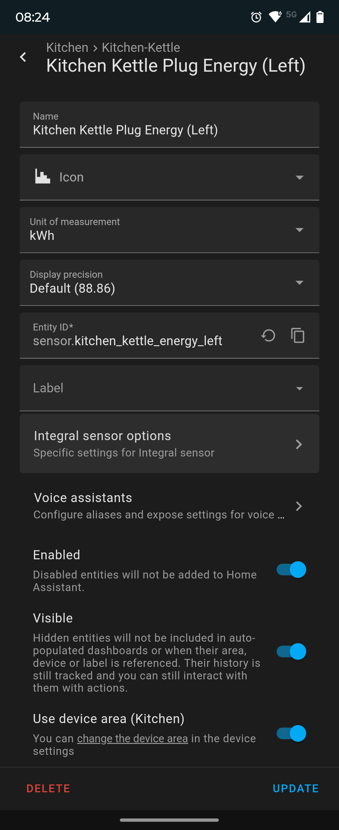

I’m using the UI, sorry if it’s something obvious I’m missing…
What happens if you change the unit to Wh?

Reasonably confident it’s to do with how often it polls the power figure, so if the kettles pulling 1200W for example, and it doesn’t poll the plug for another 30 minutes. That’d be 600kwH.
Where are you getting this claim from? The integral state is the total lifetime consumption since the integral was created.
The graph you showed of the integral shows it only increasing by .1kWh when the power updates. It looks reasonable to me.
Sounds like I’m misunderstanding how it works. I assumed it’d be on a per day basis, but clearly not. Should I be doing something to reset this helper each day?
Either way, 88.76kWh for a 2kW kettle seems pretty unreasonable. My maths, which could be wrong, says that’s been running a total of 44.4 hours… Which it definitely hasn’t.
Yes, the riemann sum helper never resets. If you want a daily measurement, you need a second utility_meter helper based on the riemann sum sensor.
Without seeing the history where this happened, can’t really speculate any further about it. Maybe the unit was changed or something in the past.
