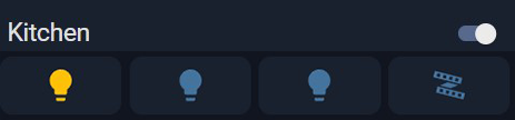

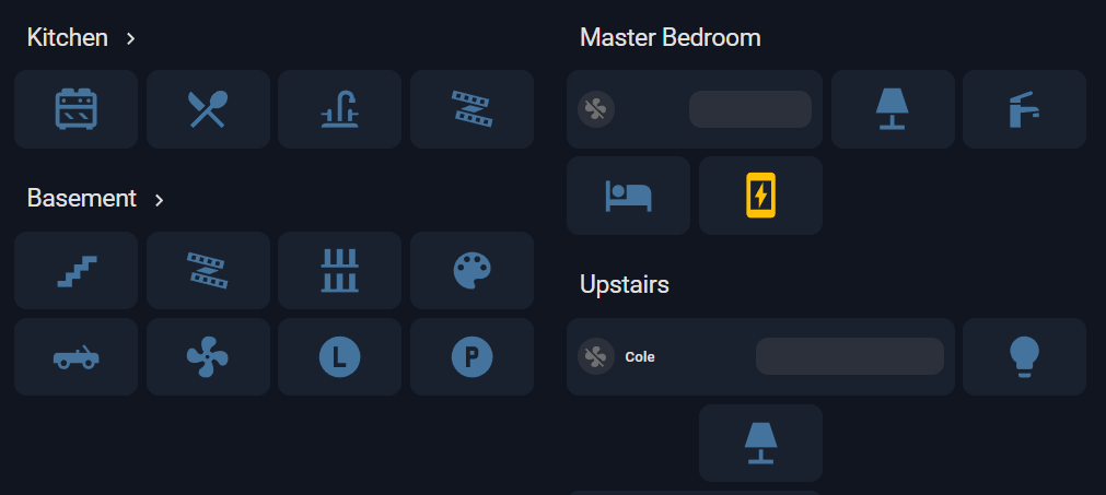

I want to accomplish this same design and functionality with buttons, something like this:
I have not found a way to do this even with custom cards. Any help is greatly appreciated!

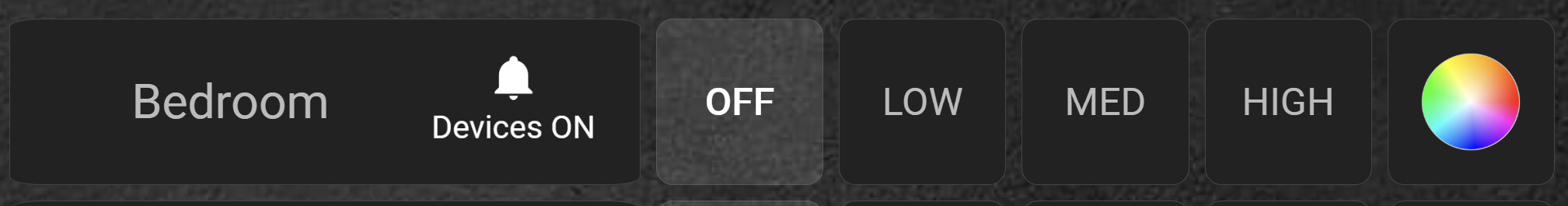

I see, I completely missed that you still had the toggle switch on the card. You could probably create a light group and have the toggle switch control that and then use the buttons to control each light. I do that for several of the rooms in my condo. For example, my bedroom has four droplights that all function independently but on my dash board have I have one button for off, low, med, and high settings which triggers a script. I also have another button that triggers a popup light card if i want more control. You should be able to use a light group in a similar way with the toggle button.

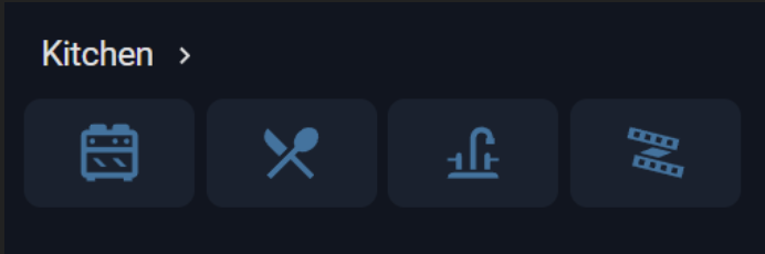

I have re-made it since using Mushroom cards instead of Button cards, but it is fairly similar:
The Title card:
type: custom:mushroom-title-card
title: Kitchen
card_mod:
  style: |
    ha-card {
      margin-top: -10px;
      margin-bottom: -12px;
title_tap_action:
  action: perform-action
  perform_action: homeassistant.turn_off
    entity_id:
      - switch.in_wall_smart_switch_120_277vac_2
      - switch.in_wall_smart_switch_120_277vac_3
      - switch.ge_quick_fit_smart_in_wall_paddle_switch
      - switch.cabinet_lights
The Buttons:
type: custom:layout-card
layout_type: custom:grid-layout
layout:
  grid-template-columns: repeat(5, 1fr)
  margin: 0px 0px 0px -4px
cards:
  - type: custom:mushroom-light-card
    entity: switch.in_wall_smart_switch_120_277vac_2
    primary_info: none
    secondary_info: none
    fill_container: true
    grid_options:
      columns: 1
      rows: 1.2
    icon: mdi:pot-mix
    layout: vertical
    card_mod:
      style:
          ha-card {
            height: 70px !important;
            width: 70px;
        mushroom-shape-icon$: |
          .shape {
            --icon-symbol-size: 32px;
            --icon-size: 46px;
    entity: switch.in_wall_smart_switch_120_277vac_3
    primary_info: none
    layout: vertical
    grid_options:
      columns: 1
      rows: 1.2
    icon: mdi:silverware
    card_mod:
      style:
          ha-card {
            width: 70px;
          .shape {
            --icon-size: 46px;
    entity: switch.ge_quick_fit_smart_in_wall_paddle_switch
    primary_info: none
    layout: vertical
    grid_options:
      columns: 1
      rows: 1.2
    icon: mdi:faucet-variant
    card_mod:
      style:
          ha-card {
            width: 70px;
          .shape {
            --icon-size: 46px;
    entity: switch.cabinet_lights
    primary_info: none
    layout: vertical
    grid_options:
      columns: 1
      rows: 1.2
    icon: ""
    card_mod:
      style:
          ha-card {
            width: 70px;
          .shape {
            --icon-size: 46px;

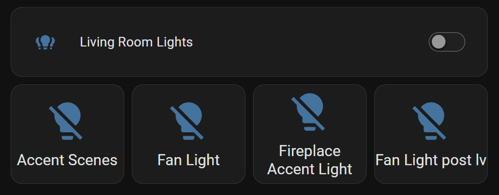

There are many ways to do this. Using a Group Helper and auto-entities is the least amount of YAML / templating I think. I did a quick/dirty, you can change all the visuals you'd like...
type: vertical-stack
cards:
  - type: entities
    show_header_toggle: false
    entities:
      - entity: light.living_room_dimmer_group
        name: Living Room Lights
  - type: custom:auto-entities
    card:
      type: grid
      square: false
      columns: 4
    card_param: cards
    filter:
      template: >
          {% for e in expand('light.living_room_dimmer_group') %}
              "type": "button",
              "entity": "{{ e.entity_id }}",
              "name": "{{ e.name }}",
              "tap_action": {
                "action": "toggle"
          {% endfor %}

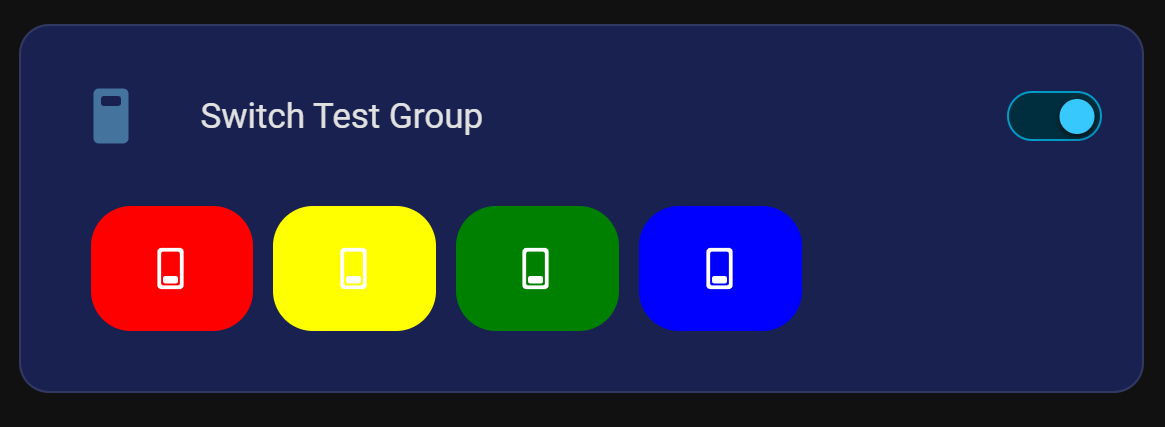

@chris.reeve4 I'd suggest this as an alternative method
Create a switch group for the devices and then add a label like switch-group to those specific device. As Ltek mentioned, other methods are available so use this as a starting point.
type: custom:vertical-stack-in-card
cards:
  - type: entities
    entities:
      - entity: switch.switch_test_group
        card_mod:
          style:
            hui-generic-entity-row$: |
              state-badge {
              display: none;
    card_mod:
      style: |
        ha-card {
         border: none;
         font-size: 20px;
    filter:
      include:
        - options:
            type: custom:mushroom-entity-card
            tap_action:
              action: toggle
            primary_info: none
            icon_color: accent
            card_mod:
              style:
                  .shape {
                   --icon-size: 46px;
                  ha-card {
                   width: 70px;
                   margin-left: 10px;
                   border: none;
          label: switch_group
    card:
      type: grid
      columns: 4
    card_param: cards
card_mod:
  style: |
    ha-card {
      border: none;
     font-size: 20px;

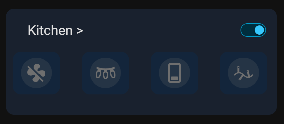

hands down the simplest way to do this is with the built in cards, however it may not look exactly how you want.
type: entities
entities:
  - entity: light.garage_temporary_laser
footer:
  type: buttons
  entities:
  - update.button_card_update
  - input_button.test
  - button.fan_ping
  - script.notify_alexa_ui
or
type: entities
entities:
  - type: buttons
    entities:
    - input_button.test
    - button.fan_ping

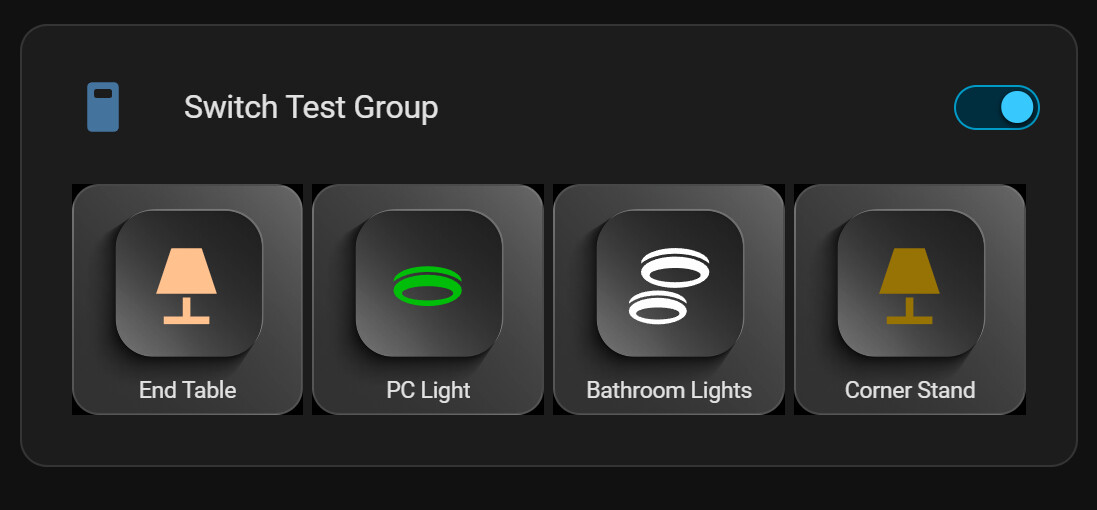

The method you suggested is :100: customizable
Custom cards can be used as well
type: entities
entities:
  - type: custom:layout-card
    layout:
      grid-template-columns: 1fr 1fr 1fr 1fr
    cards:
      - type: custom:button-card
        entity: light.end_table
        color: auto
        aspect_ratio: 1/1
        show_icon: true
        show_state: false
        show_name: true
        styles:
          card:
            - font-size: 10px
        entity: light.pc_light
        color: auto
        aspect_ratio: 1/1
        show_icon: true
        show_state: false
        show_name: true
        tap_action:
          action: more-info
        styles:
          card:
            - font-size: 10px
        entity: light.bathroom_lights
        color: auto
        aspect_ratio: 1/1
        show_icon: true
        show_state: false
        show_name: true
        styles:
          card:
            - font-size: 10px
        entity: light.corner_stand
        color: auto
        aspect_ratio: 1/1
        show_icon: true
        show_state: false
        show_name: true
        styles:
          card:
            - font-size: 10px
