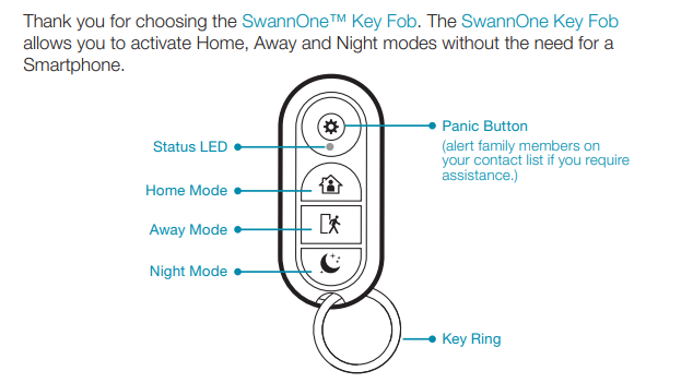

Welcome to the forums. You got me curious & I googled that model. I don’t see a disarm button anywhere:
How exactly did you set it up to send a disarm command?
