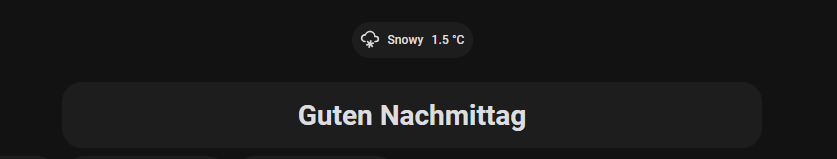

I’m new to creating my own components in Home Assistant and I’ve been working on a custom Badge for my dashboard to display a weather entity.

Also, does anyone know how to recreate this accordion-style menu in the form editor?
And lastly, how can I access the Translations for entity states (e.g. to show localized state names in the badge)?
