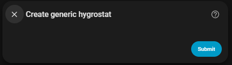

I am trying to create generic hygrostat helper via UI but unlike other helpers when I select it it does not show any options/fields to fill just a window ’ Create generic hygrostat and Submit button, which does nothing when I press it…
I tried creating other helpers like Generic Thermostat and that shows fields to be filled with sensors etc and worked as expected.
I found some threads pointing to browser caching but opening in different browser (tried Edge and Chrome) did not make any difference
What could be a problem here?

Empty generic hygrostat creation dialog:
<img width="620" height="181" alt="Image" src="https://github.com/user-attachments/assets/d52aa85b-a1a9-433c-8460-0d42fdc3d4fa" />
Upon inspection a following error occurs during dialog pop-up: `Uncaught (in promise) Error: Selector device_class not supported in initial form data`
