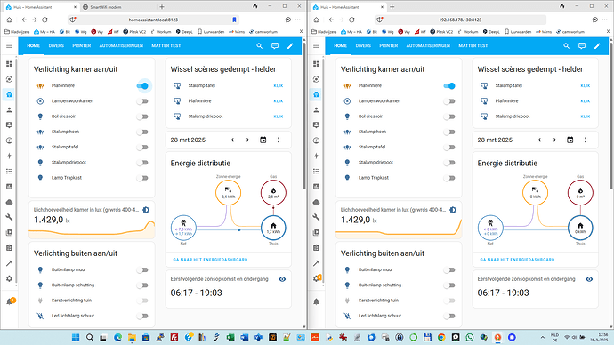

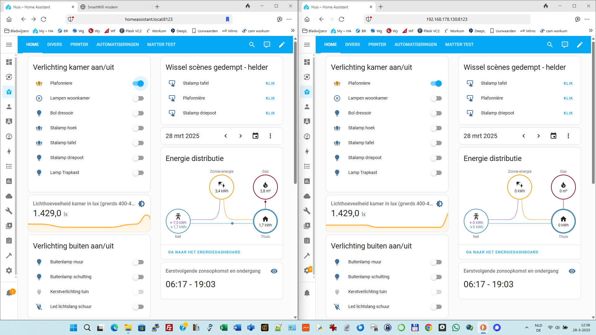

The old Windows 10 laptop now replaced with a Windows 11 mini PC. Installed on that also a Virtualbox with HA. Tried again to run both instances of HA simultaneously. To my surprise that now works without problems. The URLs must of course be different and for the second instance we use the IP address in the URL instead of ‘homeassistant.local’. See screenshot.
When running two identical instances of Home Assistant gives with the current version of HA (2026.1) an error message (duplicate Home Assistant instance detected). When selecting the error you get a pop-up with the option to repair this. The explanation states that it could lead to network instability and excessive traffic. In my case this situation occures only a short time during upgrading my Home Assistant instance on the backup system, so repairing makes no sense.
