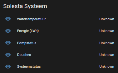

However, the values are not showing up in my dashboard. They remain as “Unknown”:
Can you help me take the next step?
Yeah I think the output is as one could expect. I have something like the following in my configuration.yaml:
command_line: !include command_line.yaml
In the same folder I have a file command_line.yaml:
command_line:
  - sensor:
      name: Solesta water temperatuur
      command: bash -c "rm -f solesta_cookies.txt >> /dev/null && curl -s -c solesta_cookies.txt --location https://monitor.solesta.nl/api/login --header 'Content-Type: application/json' --data '{\"email\": \"<YOUR_EMAIL>\", \"password\": \"<YOUR_PASSWORD>\"}' >> /dev/null && curl -s --cookie solesta_cookies.txt --header 'Content-Type: application/json'  --location https://monitor.solesta.nl/api/get_system_info?client_id=<YOUR_CLIENT_ID>"
      unit_of_measurement: "°C"
      value_template: "{{ value_json.water_temp | float }}"
      json_attributes:
        - energy_tank_kwh
        - pump_status
        - showers
        - system_status
      scan_interval: 300
Make sure that you replace <YOUR_EMAIL>, <YOUR_PASSWORD> and <YOUR_CLIENT_ID> and as far as I know you should be good to go
