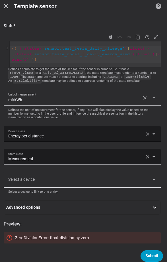

Hi I am trying to create a sensor to calculate my daily ev efficiency. I have daily numbers for kwh used and miles so I just need to divide the 2 daily.
I tried doing it this way but the value returns this:
Ideally it would do this calculation once a day at the end of the day.
Tried messing with automations and time triggered templates but have not really had any luck.
If anyone could assist in getting this to work I’d greatly appreciate it.
Your template is straightforward, it simply divides two numbers and rounds the result.
{{ ((states('sensor.test_tesla_daily_mileage') | float) /
  (states('sensor.tesla_model_3_daily_energy_used')|float)) | round(2) }}
However, it doesn’t guard against the possibility that the divisor can be zero. When it attempts to divide a number by zero, the result is an error message:
Try this version. It reports 0 if the daily energy use is 0 otherwise it performs the division.
  {% set mileage = states('sensor.test_tesla_daily_mileage') | float(0) %}
  {% set energy = states('sensor.tesla_model_3_daily_energy_used') | float(0) %}
  {{ 0 if energy == 0 else (mileage / energy) | round(2) }}
