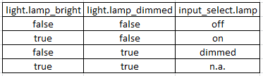

I would like to implement the following table in home assistant:
This table should be handled in both directions:
If input_select.lamp is changed, the both light entities should also be changed.
If the light entities change, the input_select entity should be changed.
