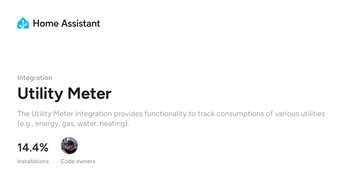

The utility meter can take a cron expression:
cron string Required
This option is mutually exclusive of cycle and offset. It provides an advanced method of defining when should the counter be reset. It follows common crontab syntax but extended to support more advanced scheduling. See the croniter library.
Daily:
0 0 * 10-12,1-5 *
Monthly:
0 0 1 10-12,1-5 *
