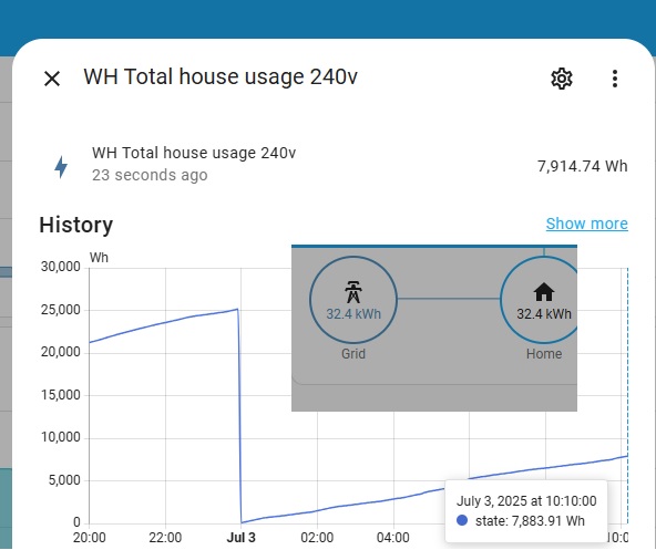

Created several template energy sensors for daily recording but one is not breaking over to next day as 0
Hello…
Thx to you guys here in the forum i was able to get my emporia vue working on esphome…
Now i found out that it does almost all correct, but it does not calculate the daily usage correct.
So i created a couple template integration sensors to group double breakers (shown as first code sample below) and now wanted to add all the usages of all my breakers to a daily sum for the energy panel (also shown as second sample below).
So all the sensors are setup the same…wh, device lass energy, state class total increasing…and all sensors but the all in one sum are resetting on day break as needed…
does anyone see/know why the total sum one is not breaking to 0 at day change?

Are you sure that the ones like these are resetting one too? They do not have daily in the name.
If you intend this for the energy dashboard:
The danger with this sensor is also that not all sensors will reset exactly at the same time. The drop will be in stages. So you cannot use this sensor in the energy dashboard. That will be confused by the intermediate steps.
It is safer to add full totals and put a utility meter around it to do the resetting, or add the sensors to the dashboard separately.
