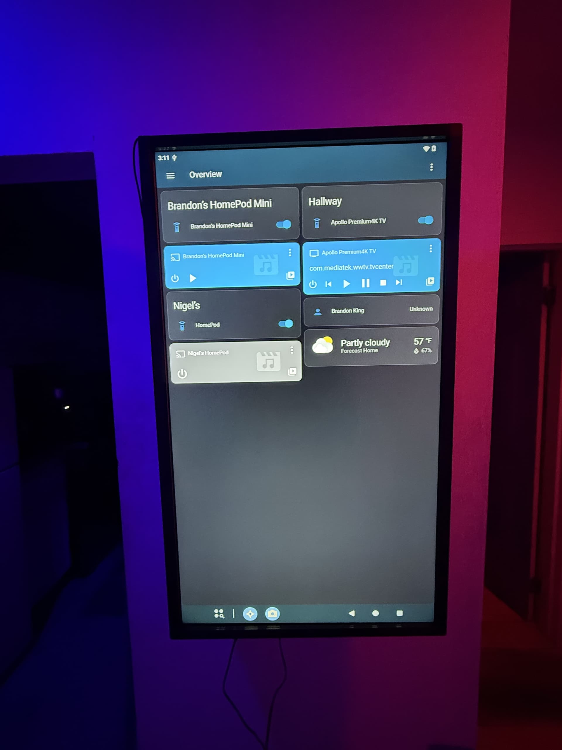

Creating A Large Home Assistant Display: Instructions
In short making a wall mounted home assistant dashboard is very easy some have resorted to simply embedding tablets in the wall, but for those after size there’s still another option! Essentially it involves installing Android OS on a raspberry pi & connecting it to a monitor which touch input. In a prior post I made my solution was a tv + ir touch frame + the rpi running android but i wanted to give detailed steps and a better way of achieving the same goal. IR touch frames aren’t bad but they often never fit any tv’s frame exact to size and require you to mount it to the tv in a way that seems very DIY. So why not just go with a monitor that already has touch input in it and direct to the rpi and this is the guide to do so along with some screen options…

I really recommend the touchwo screen, they actually make the koisk we see in mcdonnalds and other fast food chains (you can even buy one of those as well for those of you who use HA for business and ever was interested lol)
Mounting Options
Also keep in mind these monitors also go portrait mode as well as traditional landscape and for somethings your going to want to quickly be able to rotate the display and change the view to portrait/landscape. So shop vesa mount for your display that allows for 180 degree rotation.

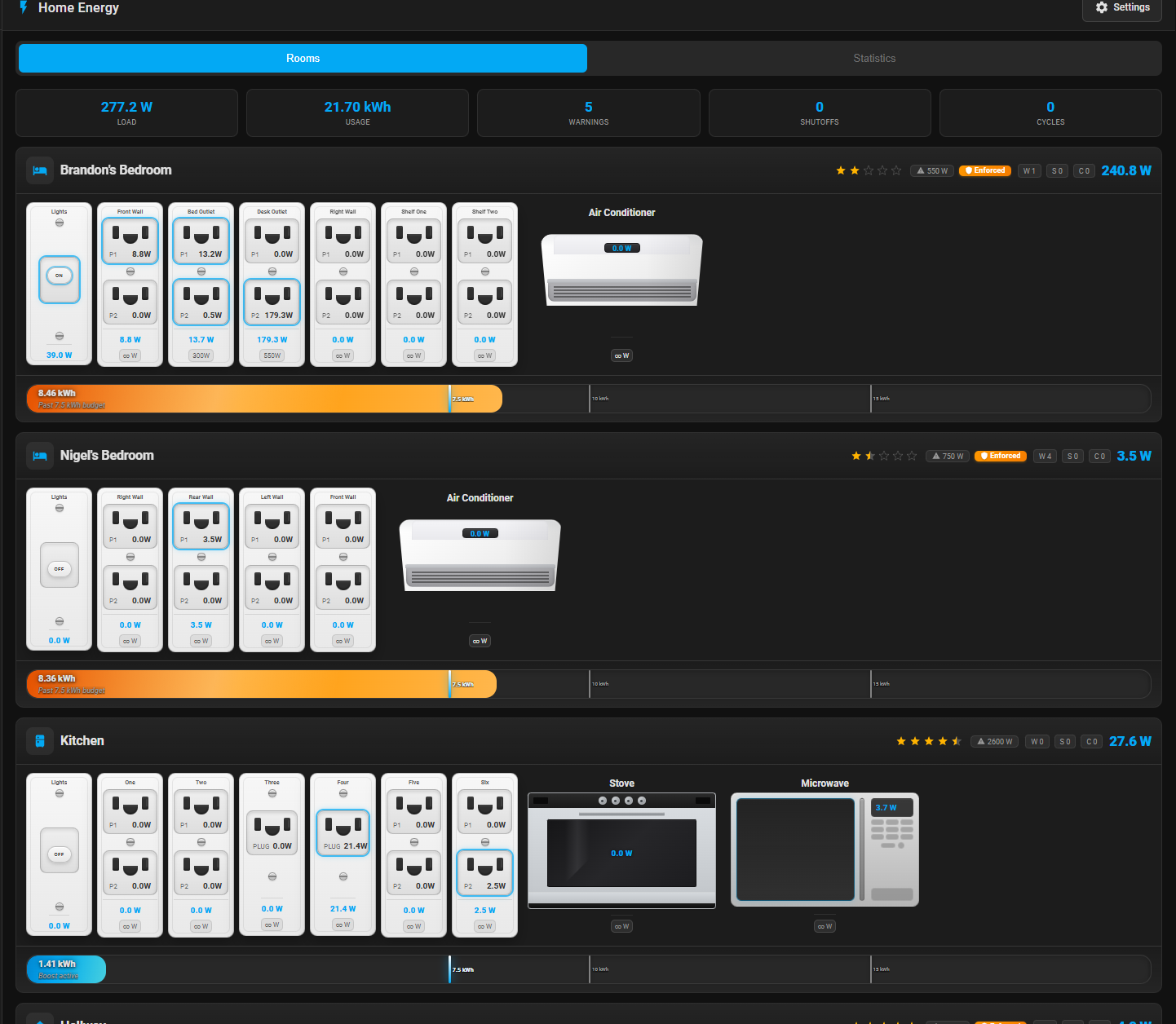

My question is do you just leave it on all the time? I know i can use Fully Kiosk or maybe Wallpanel to schedule but curious how you do it.
I am interested in one of the dashboards perhaps showing pictures, something that could go back to the main dashboard for x time once hit, maybe added a proximity or sensor of some type.
I have presence sensors in my home in every room including hallway, paired with every outlet is a smart outlet so hallway presence turns on the screen, no presence after a time turns it off. for your case your can use a smart plug like 15 bucks, go zigbee if you can but if you do want to make the change with us tp link smart outlets for entire home their locally controlled so can work without internet access i use them for power monitoring and advance automation to cut down on electric
