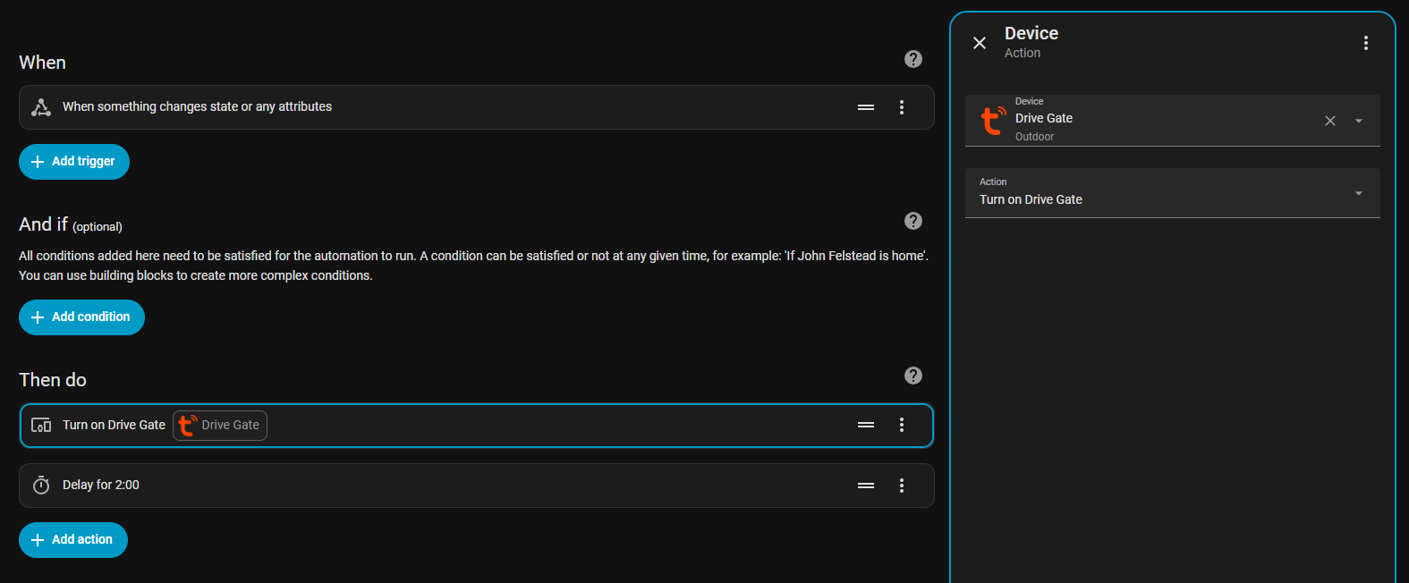

First I associated the routine with the “Toggle Drive Gate” entity and then “Turn on Drive Gate” entity but neither achieve the gate opening for 2 minutes. The boolean helper has a time of 2 minutes but the gate still only opens for its default period of 30 seconds as triggered by inching mode. I really don’t know what I am doing wrong. Am i going about this all wrong. I just want a button or toggle on the dashboard which I can action that opens the gate for a set period.

The next part is where I get stuck. I don’t want to change the existing inching mode so thought I needed to create a virtual switch or button to use as the Action for the routine but cant work out how to do that. Secondly I can work out how to set a delay after the action but it doesn’t effect the time period the gate remains open.
Here is a screenshot of the automation GUI
If I run the automation it completes successfully but the gate only opens for the default duration of 30 seconds rather than 2 minutes??
