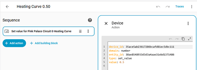

This is one of the scripts. I’m completely new to this, so I’m sorry if I’m using the wrong terminology.
So, what this automation does, is that it runs every 15 minutes. It then ecks if the temperature is above 12, and if it is, it runs this script. All the script does is that it sends a value. Instead of having a number of scripts, I would simply have the action as a part of the automation. And you can trigger the automation on a change of the outside temperature, so it doesn’t have to run every 15 minutes. A neat thing about triggers, is that the thing that is triggered on is stored in a variable that you can tempuse. So if you use a numeric state trigger, this will trigger every time the temperature changes. The current temperature is then available in your automation as {{trigger.to_state}} and the previous temperature as ‘{{trigger.from_state}}’. You can then use a choose block to select which value to send.
Does that make sense to you?
