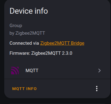

This results in a sub device page that has the Connected via data, like Z2M:

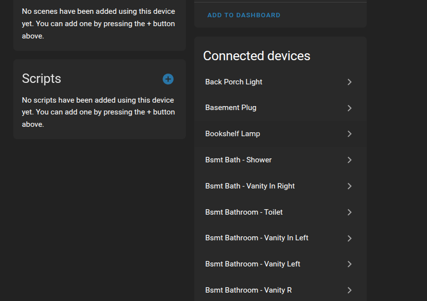

And a master device page that has a Connected devices card:
