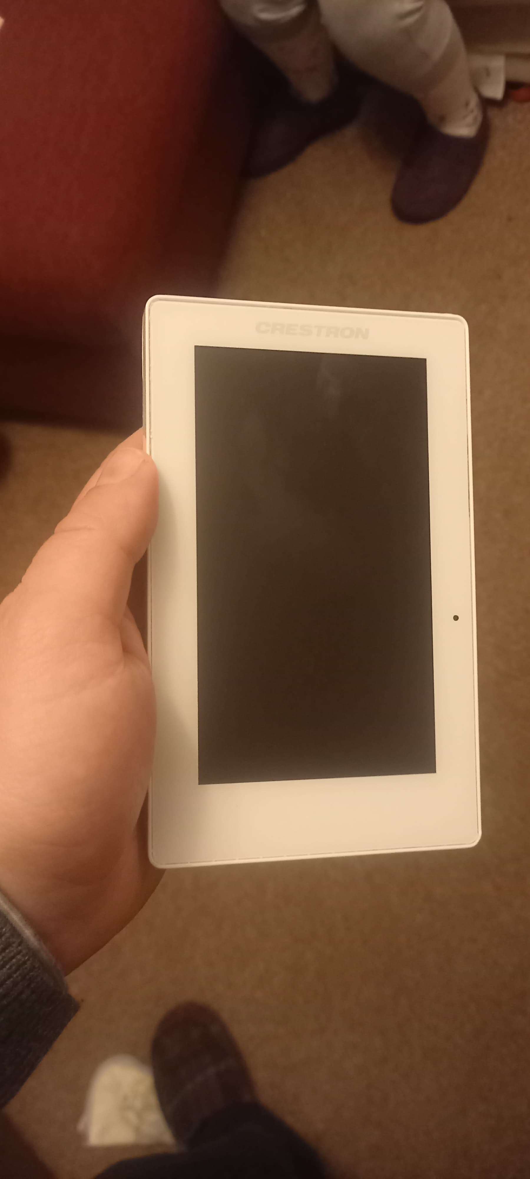

Anyone in UK that wants to convert but does not habe the tools PM me and we can talk.

I now have 7 TSW-560Ps so will get a flash read.from them and the TSW-760 that came with them. That will confirm two more config sets and checksums.

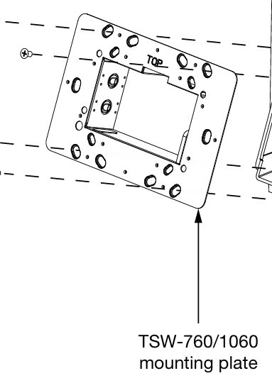

Actually, marginally related: does anyone know where I can get the wall mount plates for the 760s/1060s? I don’t have access to a 3D printer so I can’t use the above-listed template, and eBay wants $100+/mount – at which point, it’s cheaper to just get more TSWs.
You could also try looking for TS-7-MSMK (or replace TS-7 with whatever panel you have), it’s not an in-wall mount but an adhesive one.
Unless you’re looking for just the TSW mounting plate that comes with the touchpanel
In which case, you could try calling some local AV Integrators to see if they have any to scrap, or alternatively a lot of libraries these days have public use 3D printers, you could check your local ones to see if that’s an option or just use a print to order site.

I find a set of $15 32mm magnets with an inset center hole work fantastic. I’m guessing you’re not in the UK but would offer to print you one if you were closer as a thanks.

Amazing offers, thanks guys. I’m going to try to get a couple mounts from some people who DM’d me, and just get some more tablets to spare in case I break them. Good news is I should be able to get more hardware combinations for church’s spreadsheet.
