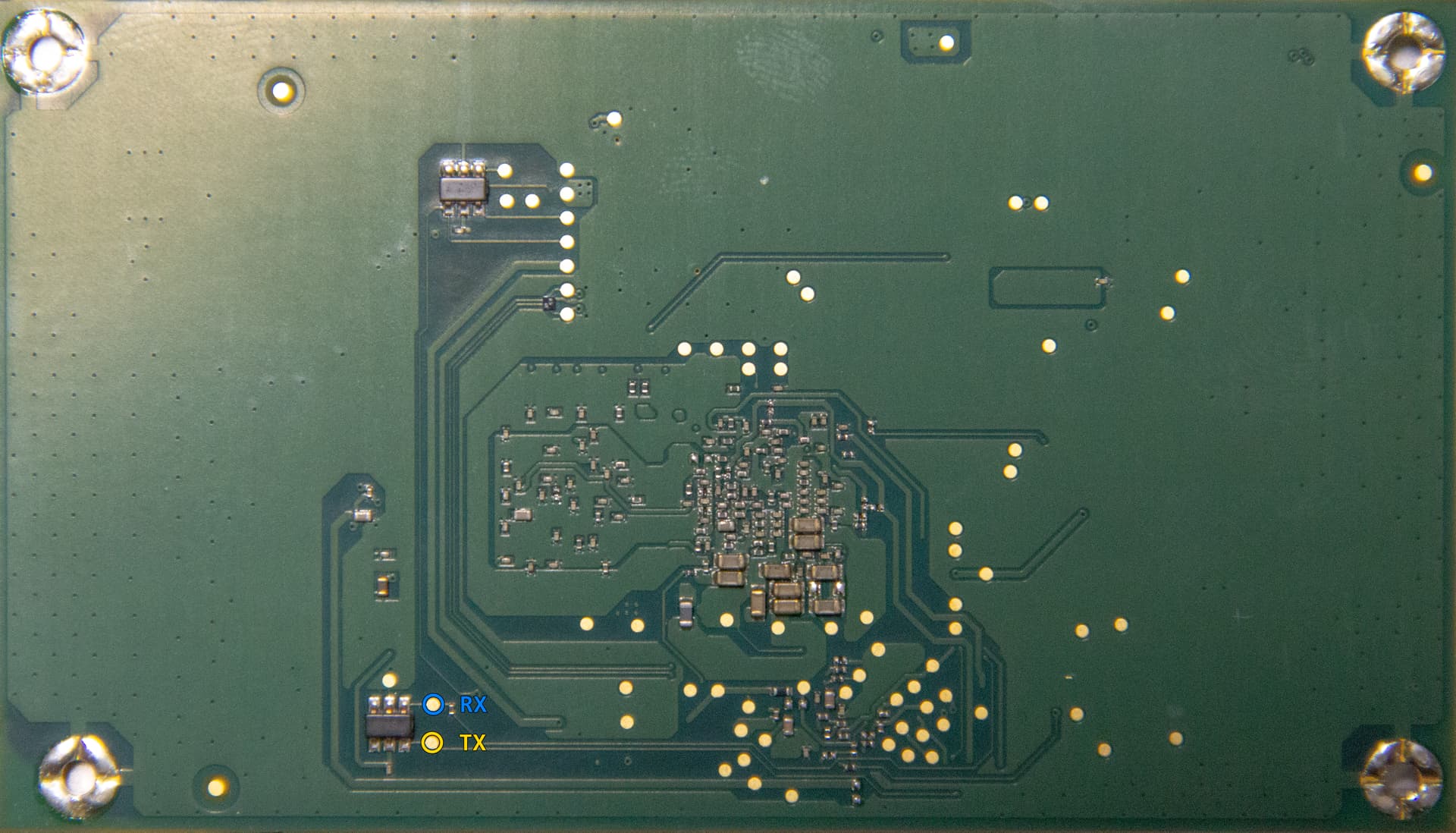

UPDATE 2: Some board shots of the 770. Now to try to find UART.
UPDATE 3: I’ve probed every contact on the bottom side of the board and couldn’t find a UART. This isn’t really my skillset, but it seems odd. There should be one per boot.img:
console=ttyMSM0,115200,n8 androidboot.console=ttyMSM0

I suspect the circled pins might be UART. I’m not super experienced with hardware level debugging, but in my experience with networking equipment, UART headers are often laid out in a straight line like in your photo. I’m not certain if Crestron follows the same layout but it’s certainly a possibility. Any chance you might be able to provide a close up of the chip adjacent to those pins? I’ll crack open one of my 770s and see if I can get serial access with those pins.
I thought it was too, but no luck when I tried it.
Now, it’s very possible that my puny 24MHz logic analyzer and assumption about 115200 baud are incorrect, but I did try every pad and none of them gave me what looked like a sane UART stream.
The chip next to it (and the same one below) only has the markings 64 6 on it. I’ve reassembled my 770 in the meantime to poke at its software, so I can’t easily grab photos at the moment. I’ll do so again once I have it open again - alongside photos under the copper shield – I just need to wait for a cheap Amazon rework station to show up and replace my broken cheap Amazon rework station.

Alright while poking around on the xx70 board I didn’t see anything that looked like the 3v3 UARTs that the previous versions of these had. I looked in the dtb file in the boot.img and saw the SOC in these is a MSM8953 + PMI8950 QRD SKU3 (a Snapdragon 625). The datasheet for these says the UART is a 1.8V logic level, so in the interest of not blowing it up I will now be ordering yet another FT232H since all my debuggers only do 3v3.
Also, since the xx70 seems to use the built in android updater I wonder if we can use the unlocked firmware version to run that update command with a modified update package, maybe even a stock Android since this uses a Snapdragon SOC that was used in many phones.
I wonder if there’s an onboard USB interface, perhaps? The USB stack on this device should be pretty straightforward since it recognizes USB flash drives and all. I did the lazy thing and tried using an A-to-A cable but didn’t get anything - although I suppose that doesn’t mean too much (or I did something wrong).

Alright here is the xx70 UART
115200 baud
1v8 ← IMPORTANT
and once again…
Crestron Touchpanel:/ $ whoami
shell
Crestron Touchpanel:/ $ su
Crestron Touchpanel:/ # whoami
root
wonderful.
start adbd works like previous, and I was able to adb install the HA app. Since this is real Android it seems that I am unable to remount / to edit system files and such, unfortunate.
Annoying that they put all the test pads on the wrong side of the board
Realistically the 2.004.1026 vuln will be way easier to use instead of tearing the thing open (unless newer v2 firmware is better in some way?), but at least we know root over UART is there.
Beautiful find! I swear I probed those pins, but I guess my logic analyzer wasn’t sensitive enough to pick up 1V8. Ah well.
