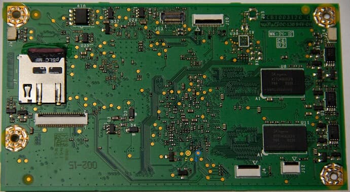

Do you get anything on the screen like a Crestron swirl logo thingy? If so, I am afraid this means corrupted SD card. This is the image I manage to get off of TSW1060 sd card with Win32 Disk Imager some time ago
Give it a go.
This sounds silly, but I have never been able to figure out how to access the SD card on my TSW-1060s. Is there a trick to it?
(Luckily all of mine are still running OK, but who knows if that will last forever or not.)
If thats healthy, you can access that using any FTP client or Crestron Toolbox File Manager. Once it dies or if you want to clone it @katia has posted a picture of the board where you can see card slot:

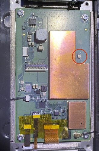

We did also get Fastboot on the xx70 series as well, so - in theory - there’s a hardware root path for the xx70s as well. I haven’t been able to get the recovery mode to work (and, honestly, might never be able to get it to do so), but with EDL we can extract /vendor, replace some key files, push a vendor image back, and then do whatever the heck we want.
For those following at home: the secret hidden button, when held, will boot the device to EDL. USB works otherwise, loader name is 000460e100290021_cc3153a80293939b_fhprg_peek.bin from any of the usual sources.
Note that it’s very easy to scrape off the button top layer by accident.

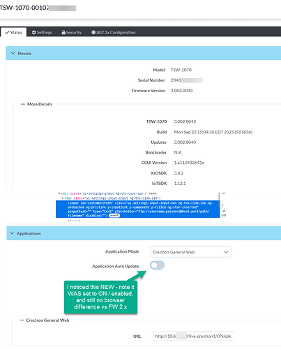

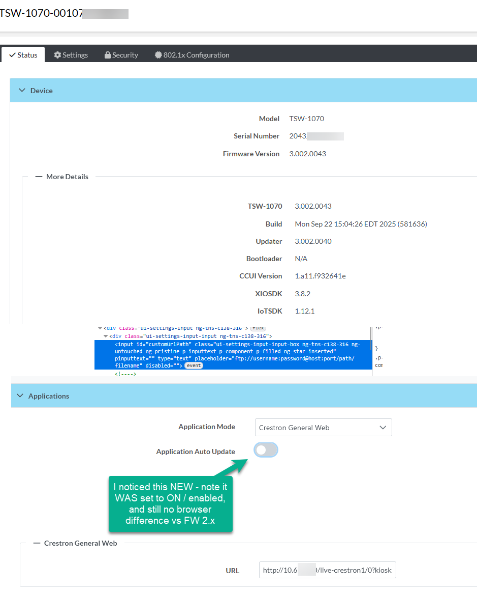

(i did notice this new setting toggle - see pict below, I’m assuming from the firmware release notes it’s pointing to the possibility of the specific web app being able to auto update (just the app) itself, it WAS enabled, yet my comments above are still the same - no browser changes/updates vs FW 2.x ).
