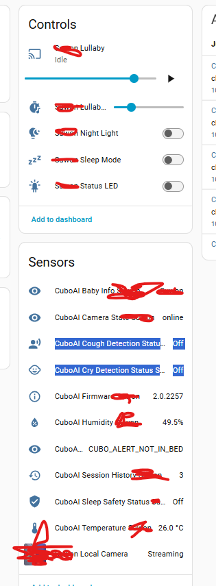

Thanks, I managed to get all the extra bits of info etc but sadly none of it works for me, all unknown and none of the toggles work, camera view doesnt load etc!

I see, it is an early version ,
Hmm did you install the latest commit ?
Can you add logs to git so I’ll can investigate it.
Can you try download latest commit ?
I think I solved it.

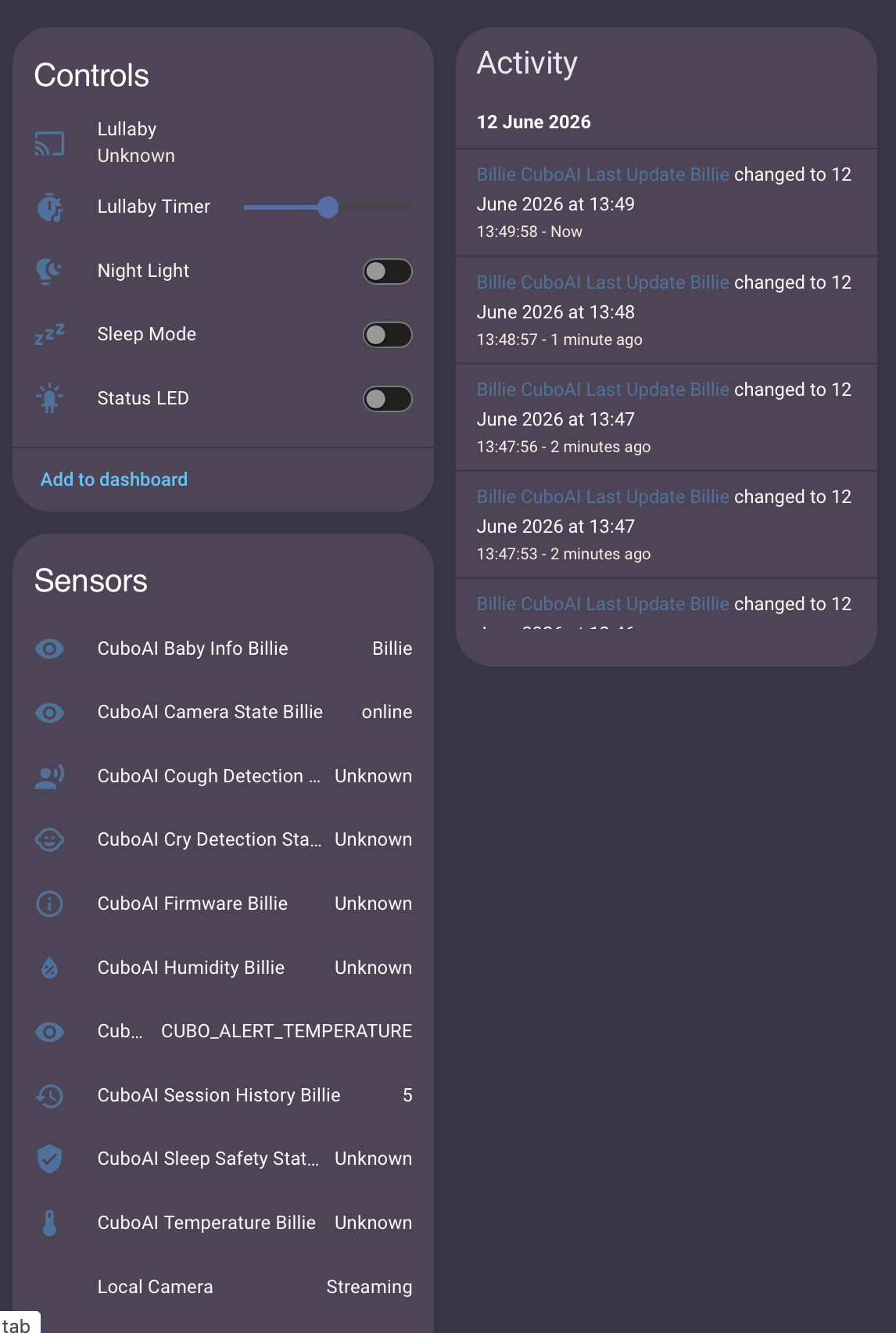

I ve just updated the integration and all additional sensors appear unknown. The stream appears a s a valid entity but when i try to open the stream itself is all blackscreen (although i can take snapshots). Any idea if I am doing something wrong?
Hi there, thanks for reporting this. Let's figure out what's going on with the sensors and the stream.
To help me troubleshoot, could you please provide a few things?
  1. Enable debug logging in the CuboAi integration options.
  2. Send over the relevant output from your Home Assistant system logs.
  3. Attach a screenshot of your CuboAi options screen so I can double-check your configuration.
Once I have those details, I'll take a closer look!
As discussed in Github all problems solved for now.
