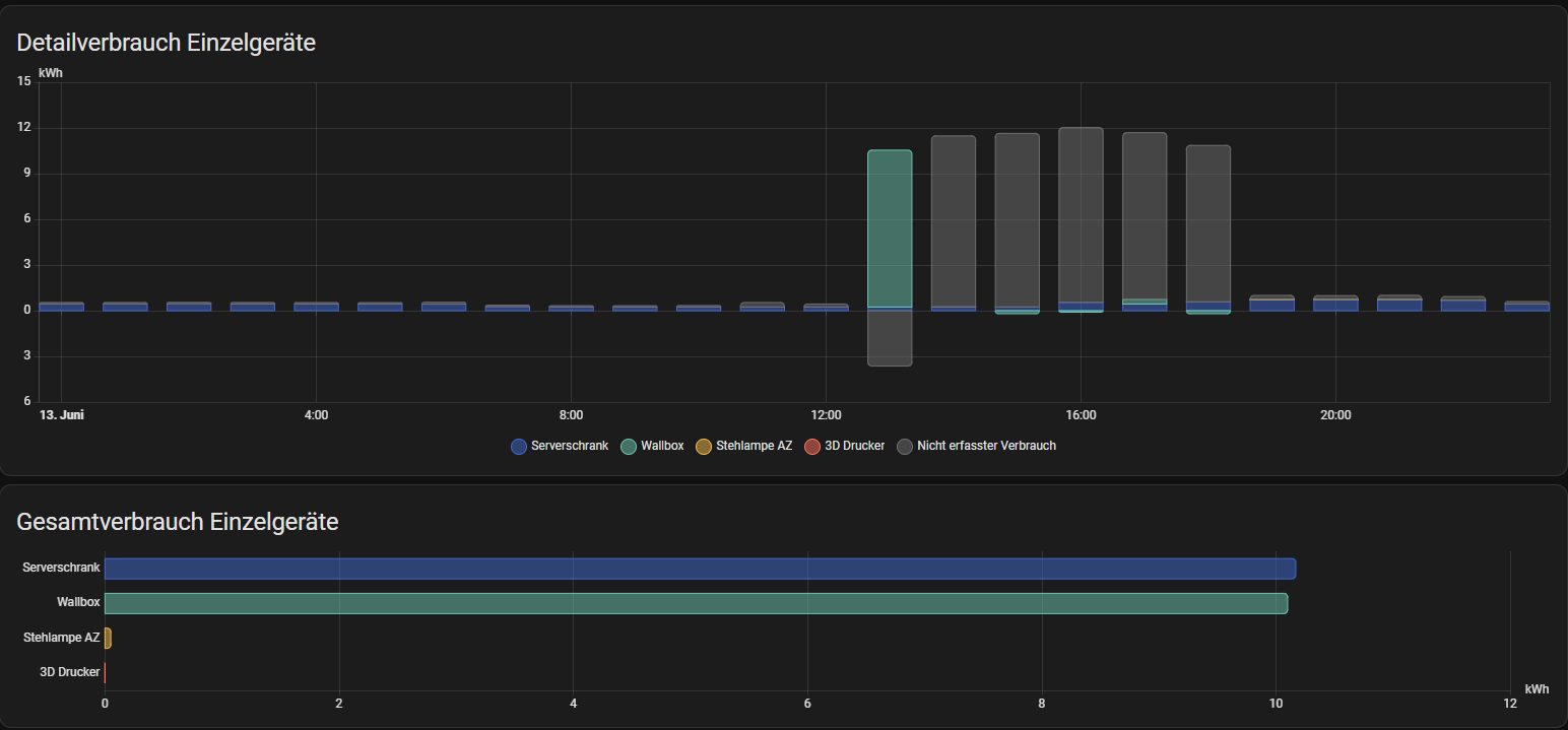

I installed the Cupra Connect plugin which gives me the Charge Power in kW and the location of the Car. I want only the loading at my wallbox in the Dashboard so i wrote the script below. Which seems to work it gives me the value in kW. Now i need to make the “Cupra_Born_Ladeleistung_Wallbox” into kWh to be used in the dashboard. I can select it but it gives me strange output seen in the Screenshot below. I have no idea what i am doing wrong. In the Screenshot “Stehlampe AZ” and “3D Drucker” are the same like the upper kwH yaml part and work fine.

My Energy Dashboard
I really hope someone can help me, im a bit frustrated. Thank you in advance.
