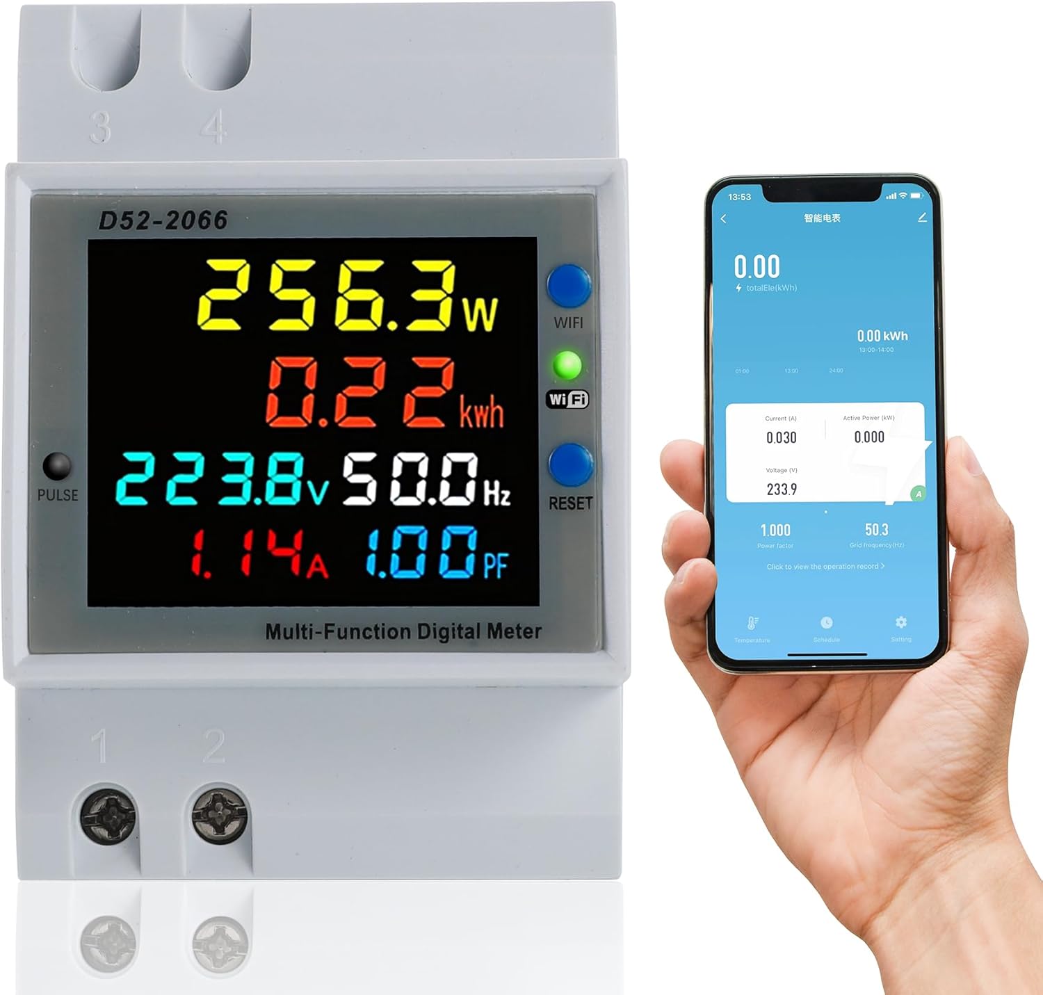

Hi, I’m new with HA, I’m trying to update every x seconds/minutes an economic Tuya-based circuit breaker which reports wattage and other stats.
Problem is it just works only when Smartlife app is open.
I tried to add it to LocalTuya and Tuya Local but it looks not compatibile (first one finds no entity, the second one finds a wrong device with just 1 entity).
Device is DM52-2066 which is sold under several names on Amazon:
(this is just an example).
Is there a way to make it updated on a fixed interval with Tuya standard integration (the only that finds the device apparently).
Can you suggest any other DIN rail device working with Home Assistant (reporting data on fixed interval).
Thanks for helping
