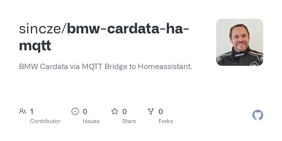

I think people are using this fork, it was updated last week.
Personally I’m having duplication issues, but I think that’s my end.

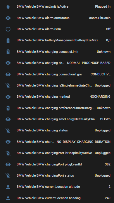

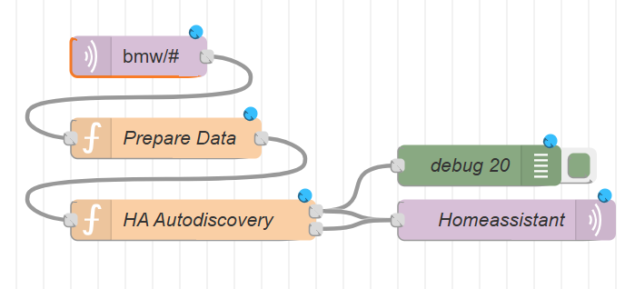

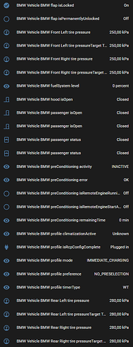

I’ve been following many threads and for me currently I used BMW CarData → MQTT Bridge for many months now to populate the data to Domoticz.
It will populate the BMW data to MQTT.
And now with some magic
I’m able to use HA autodiscovery to create my sensors. It is still work in progress.
Couple of questions…will this work for a vehicle in the US, as I think the other integrations only work with cars in the EU.
Can you share your flow?
Squid :squid:
If the bridge works the NodeRed flow will work.
So i would start with the bridge
IInstructions on the authors website worked for me to get it running.
