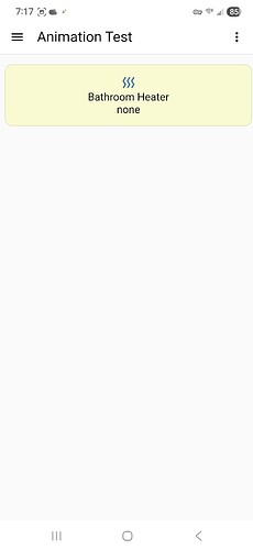

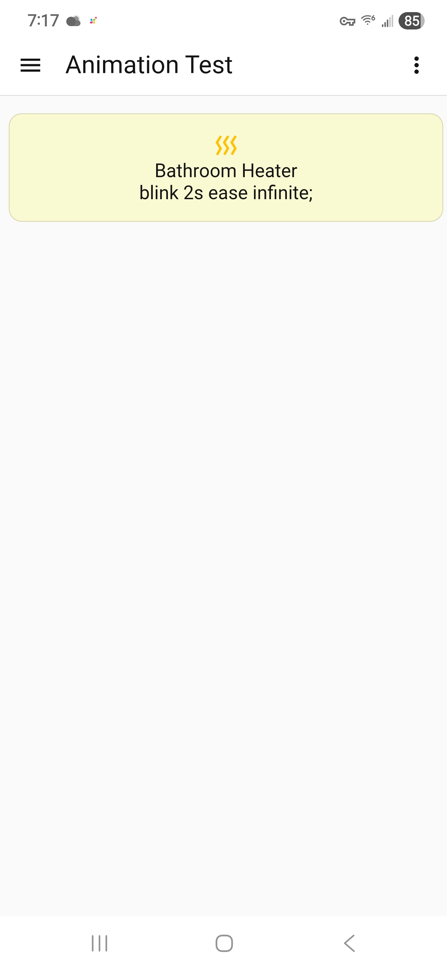

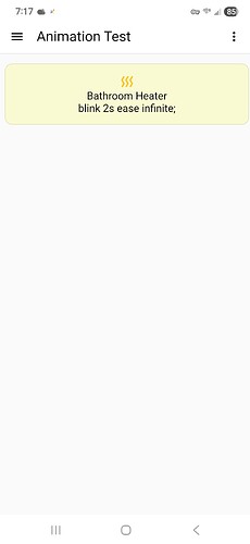

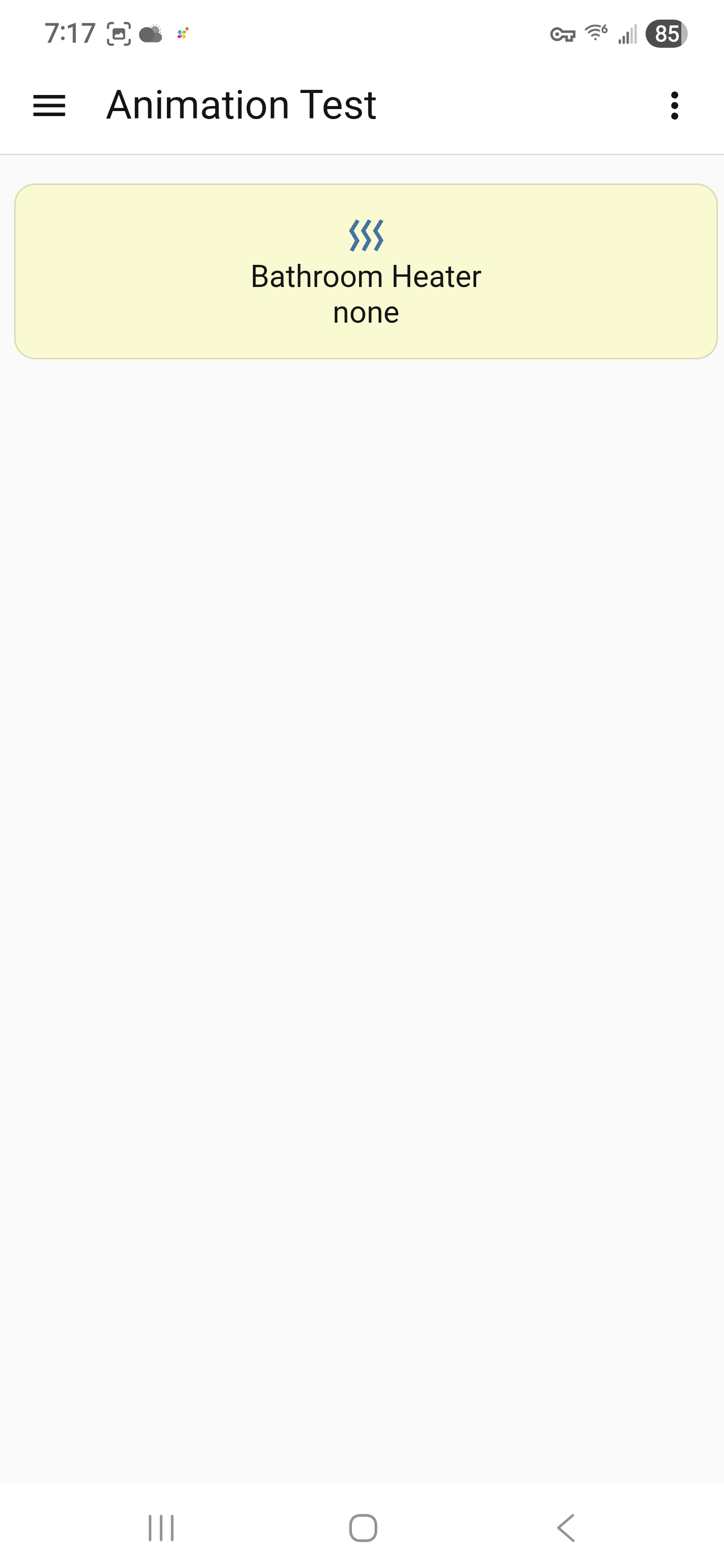

This is what I am seeing now. If I open the card in the editor, tap to turn on the device, the animation does not work. Leaving the device on and editing anything, while the editor is still open, the animation starts.
I have modified the label entry to have the same template as the animation entry and the label correctly shows the result of the template, i.e when the device is on the label shows the correct argument for the animation, when it is off it shows ‘none.’
