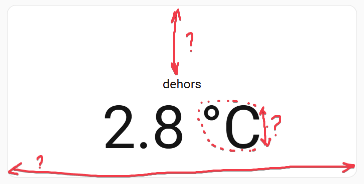

I am just starting with custom:button-card and after some very basic configuration I have this test card:
I now would like to modify the style, especially the spacing (some examples above in the image - these are just examples to set the idea). The closest I found in the documentation is Styling - custom:button-card documentation but it is still too much of a high level.
Is there a place I should look into? Or a naming condition for elements or classes, I could address in the styling? Or should I dig into the code?

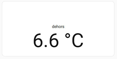

This is the code
type: custom:button-card
entity: sensor.versailles_temperature_2
section_mode: true
show_state: true
show_icon: false
show_label: false
styles:
  state:
    - font-size: 80px
for this card:
There is a big space above “dehors”. I thought (following-up on @dcapslock comment) that show_icon: false would fix that, but it is not the case.

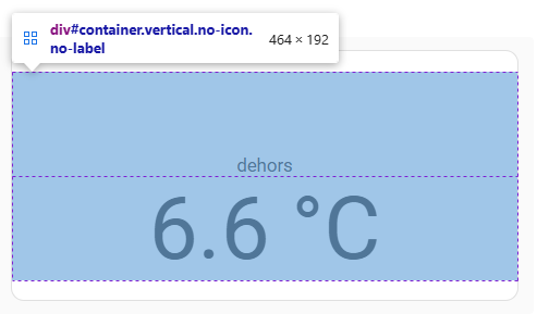

I dug a bit into the page code and I see that
It looks like the card is evenly split between its elements (grid-style) and the label is justified to the end (bottom in this case).
Is there anything I can do with the basic configuration, or should I now attack the styling of the grid layout to modify the default grid style?
Good question and yes, you can style grid-template-rows when the standard layouts don’t suit, which they won’t as they all assume icon.
All grid css can be styled in the grid styles section.
section_mode: true
show_state: true
show_icon: false
show_label: false
styles:
  grid:
    - grid-template-rows: min-content 1fr
  state:
    - font-size: 80px
