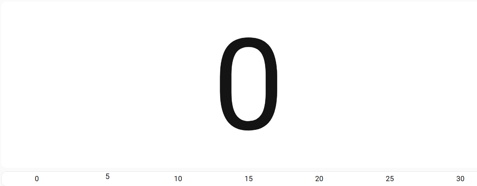

On the Hass end I set the depth I troll on with buttons in Hass, and the sonar gives Hass the depth under the boat. So when the difference is less than 5 meters I know that I may hit bottom with the weight, and I pull up. This is what it looks like on the phone that I use, and that I’m going to attach to the boat with a RAM mount:
But I would love for two things:
  1. To have the display of meters (here showing zero) go red when the difference is less than 5 meters for a more visible, visual cue.
  2. To have the buttons for 0-30 change color based on the sensor sensor.dypriggdybde (set depth of downrigger) change color, perhaps invert, based on what’s set. So when 10 meters is set, that button should change color.
