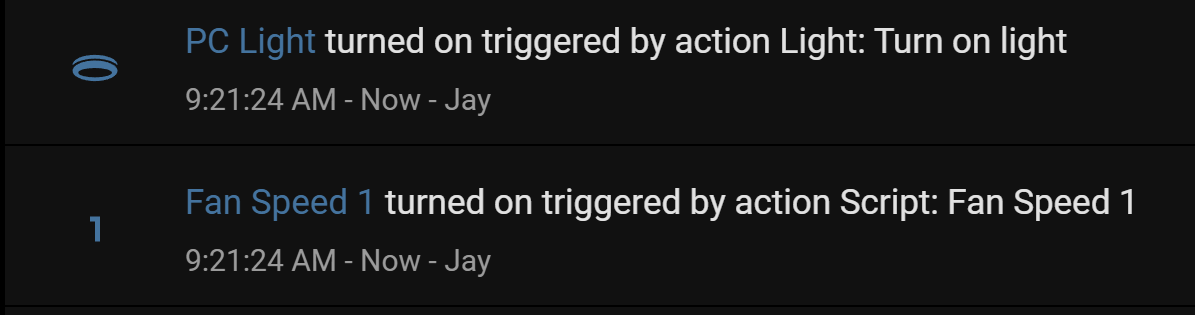

Worked fine for me
tap_action:
  action: multi-actions
  actions:
    - action: call-service
      service: script.fan_speed_1
      service: light.turn_on
        entity_id: light.pc_light
You can use - action: perform-action too
