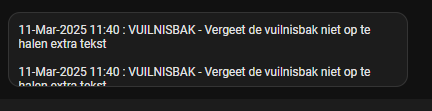

Custom:button-card not follow up style at a if statement
I’m trying to create a custom:buttoncard with custom fields and an if statement.
In de basic it is working fine.
Except that the text after the if statement is not using the style.
It is placing the text at right of the button except at the left
I now using a lot of minus signs to compensate that
The span after the else does working using the style
I tried to at style within the span brackets. All without succes.
What am I doing wrong?

Thanks for the example.
I only want all text lined out left
undependend the if state

I tried everything also using chatgpt but realy nothing is working. I start thinking it is a bug in the custom:button-card
EDIT:
I did found a solution:
<div style="position: absolute; left: 2%">
did the trick
custom_fields:
  tekst: |
      if (states["sensor.berichten"].attributes.bericht == "") {
        return '<div style="position: absolute; left: 2%">----- Geen berichten -----</div>';
      } else {
        return  states['sensor.berichten'].attributes.bericht.replace(/\n/g, "<br>") +
          '<br><br> ------------------------------------------------------------<br>- Klik om de berichten te verwijderen -</div>';
Thanks for the effort to help
