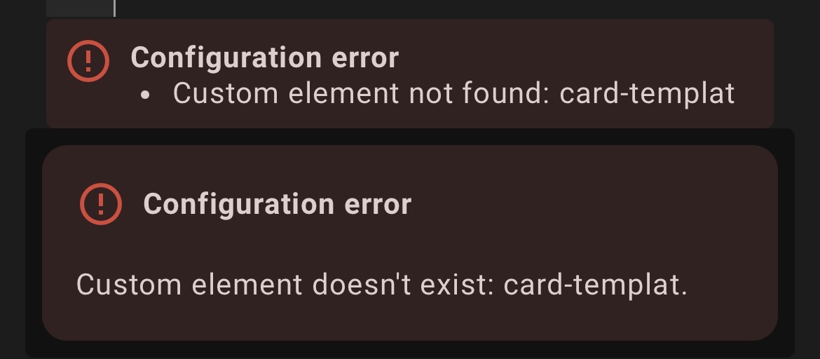

Well, do you have that custom card installed?
Of course, if not I would have configuration errors…
