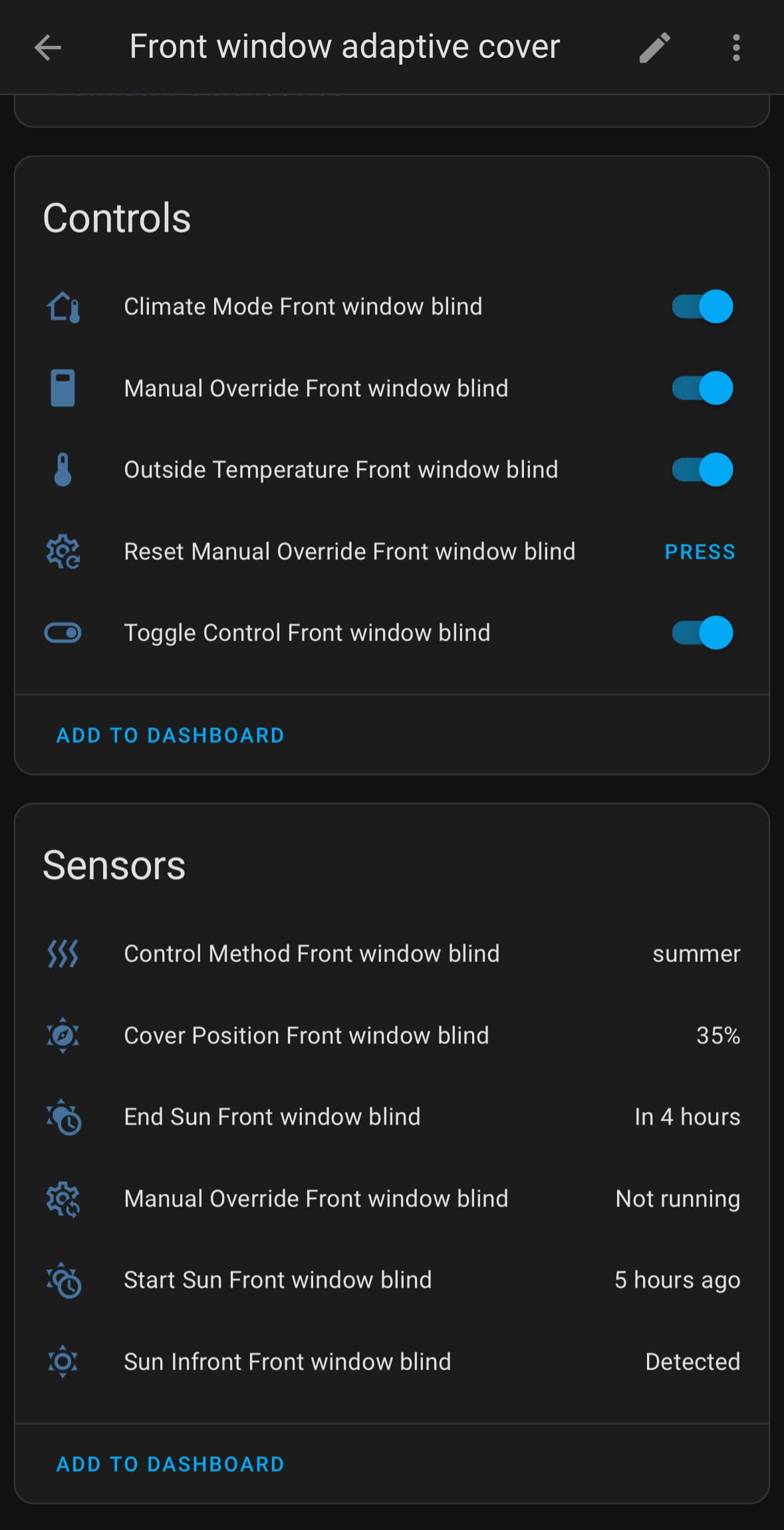

First off thanks @basbrus for the cool integration!
For anybody else banging their head a bit trying to get your system to behave as you’d like, perhaps this template sensor code can help to show what the integration is doing. I basically report my intended state under the given conditions and can compare this with actual cover control to debug my configuration. Some things in it are tailored to my own setup, and a few things are hard-coded there since I couldn’t find all necessary configuration parameteres exposed by the integration. For example:
  • I did not set an end time during adaptive cover setup, so there’s no difference between end and sunset behaviour
  • I switch the adaptive cover control toggle on and off with presence via an extra automation in order to force the blind closed instead of the adaptive cover open behaviour
  • start time and a few other things from integration set up were not accessible, so I’ve hard coded them below
Temperature behaviour is still a little confusing for me. I think this is what happens:
Outside temp switch on and climate mode switch on:
  • Outside temp > min summer temp = summer mode (blind forced close when time is between start and stop time)
  • Outside temp < min summer temp and inside temp > max comfort temp = summer mode (unintuitive mode name, but blinds don’t close now because the outside temp switch is on and outside temp is not high enough)
  • Outside temp < min summer temp and inside temp between max and min comfort temp = intermediate mode
  • Inside temp < min comfort temp and outdoor temp < min summer temp = winter mode (blind forced open when time is between start and stop time)

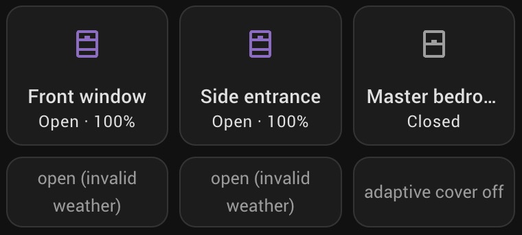

Putting some cover entities and their respective diagnostic sensors next to eachother in a dashboard worked well for me.

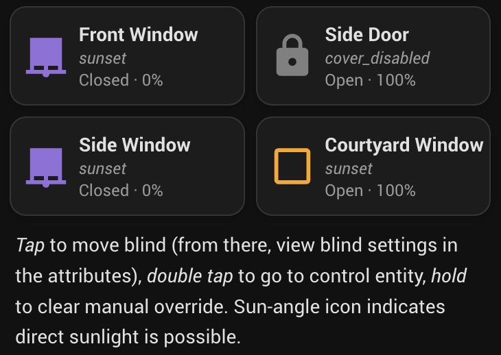

Fantastic cards design, can you share the yaml files for the cards?
The integration provides a switch to enable or disable the adaptive control. With this you can use automations or scripts to toggle the adaptive control and do what you want with the covers while adaptive cover is off.

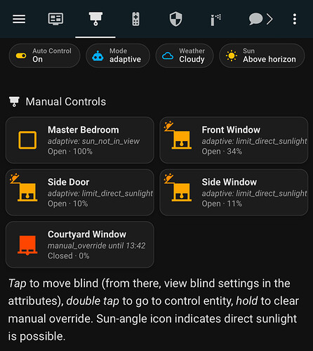

Here is the yaml for one of my cards. This is made to run with my own custom template entities (not provided by the adaptive cover integration, but based on adaptive cover and its earlier source), so you’ll have to rewrite it a bit to work with your own setup. I use a datetime helper to override cover control until the future timestamp in the helper is reached, and my own template sensor has attributes that explain the state (sunset, morning_hold, closed: hot_outside, manual_override, etc.) and if the sun is in direct view or not.
The button makes use of the custom button-card installable via HACS.

Thanks a lot cjborchert is working well with my configuration also.

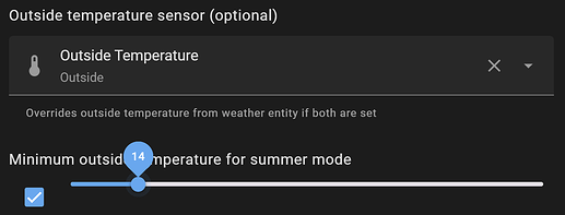

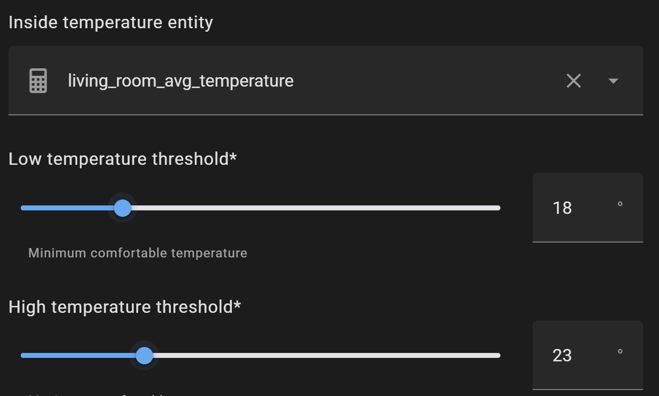

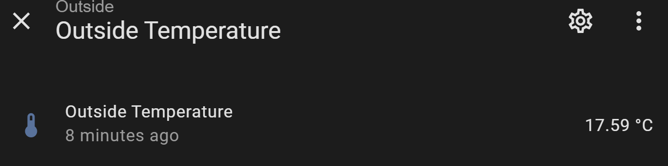

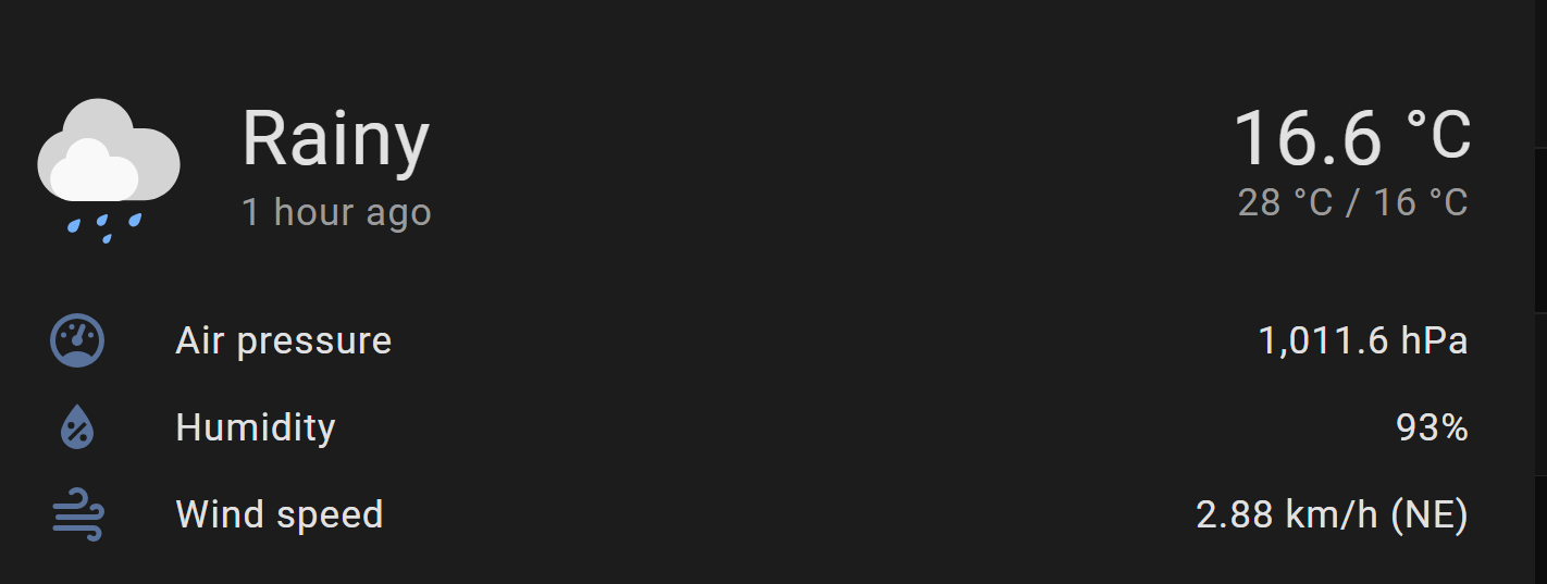

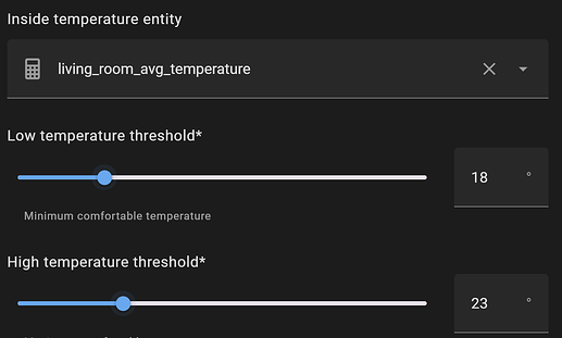

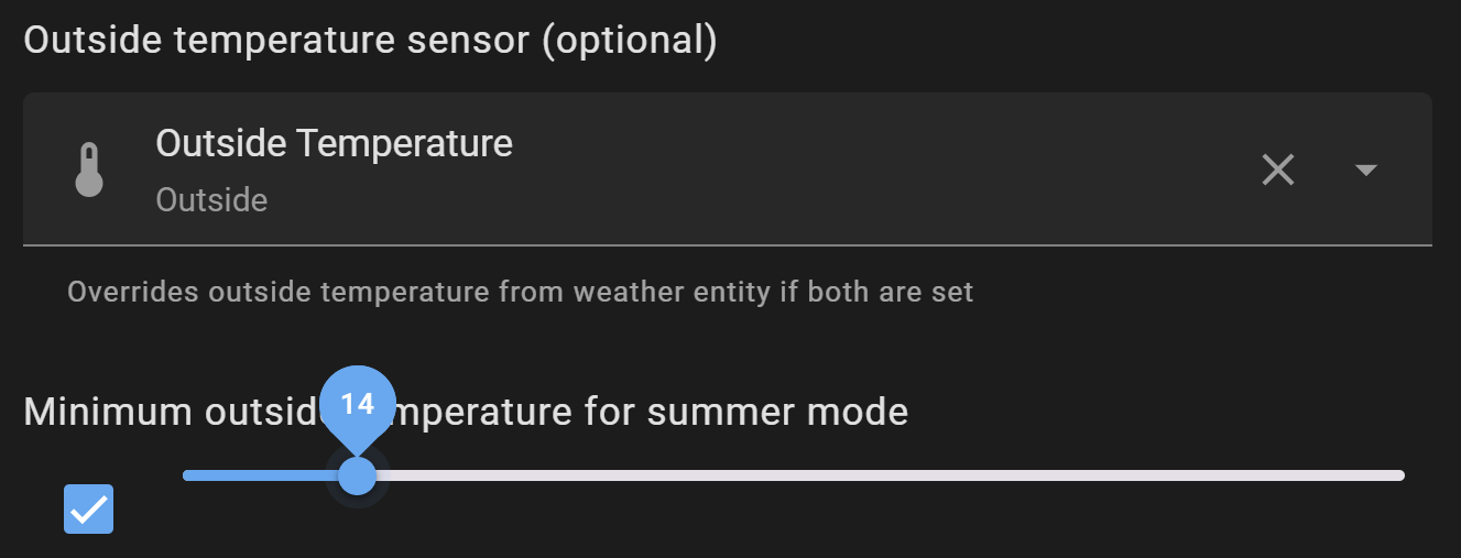

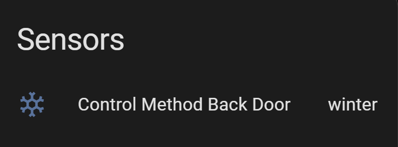

For some odd reason, my adaptive cover control seems to be stuck in Winter mode on every one of my blinds.
I’ve tried using a sensor for outside temp
Sensor:
And also removed the sensor so it should use the climate entity.
While it’s a cold and rainy day here today, it’s still well above 14C and should be in summer mode, or potentially intermediate mode since inside temp is between thresholds. But certainly not winter.

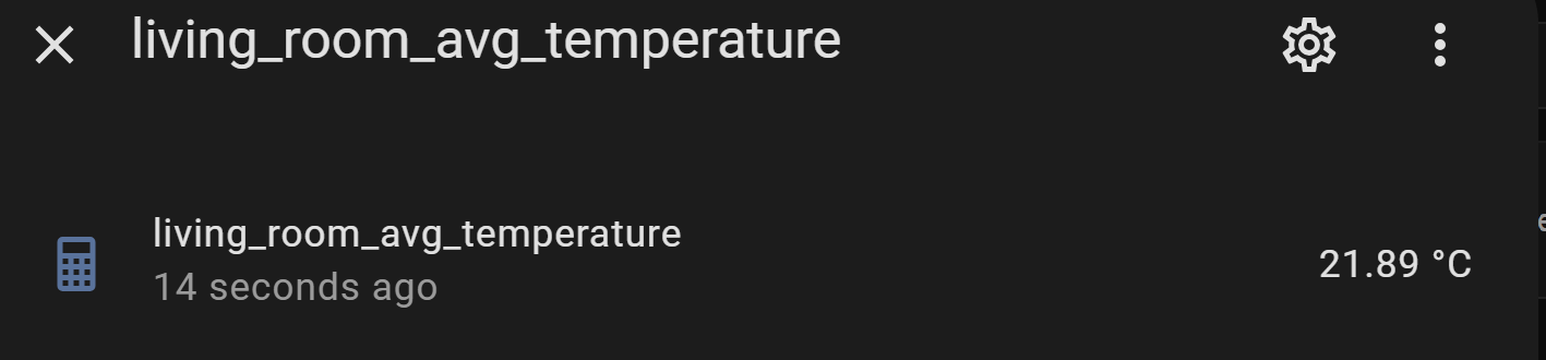

Also made sure the inside temp is not below the minimum comfort threshold.
Inside temp sensor:
