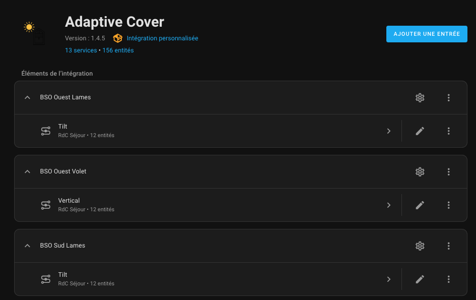

Hi, do you see something like that when you are in Adaptive Cover integration?
For now you can add two seperate services/devices within the integration; one for the vertical movement, and the other for the tilt/slat movement.
am i right to assume that it is still required to create two devices?
Yes, you have to create two entities of the same device (one for cover and one for tilt). @basbrus hasn’t made any improvements to his application for a long time

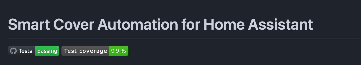

Hi everybody, seeing the complexity of this integration, I went ahead and created my own: Smart Cover Automation.
I developed it completely from scratch with a focus on ease of use and quality. I wrote an announcement post here.
Giving it a try should be quick and easy. I’d be happy to get your feedback!
