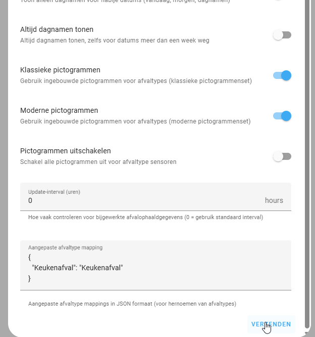

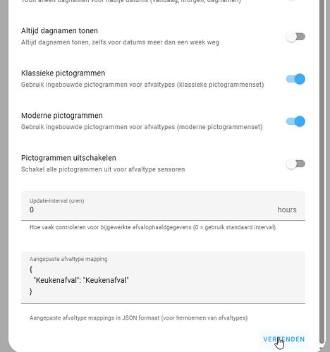

I had a custom mapping in my YAML:
    custommapping:
      Keukenafval: Keukenafval
Related to this: Missing waste fraction - keukenafval for Limburg.net · Issue #550 · pippyn/Home-Assistant-Sensor-Afvalbeheer · GitHub
The config flow added “keukenafval” to the waste types at the top:
(keukenafval was already removed when I took the screenshot)
Additionally, this was added at the bottom of the screen:
My entity (sensor.limburg_net_keukenafval) is working fine this way, however I cannot complete the config flow.
When I remove “keukenafval” as a waste type, the config flow is completed correctly. However, the result is that keukenafval is not working anymore:
Additionally, the config flow does not allow me to add “keukenafval” as a custom waste type (I could probably re-import from YAML as a workaround).

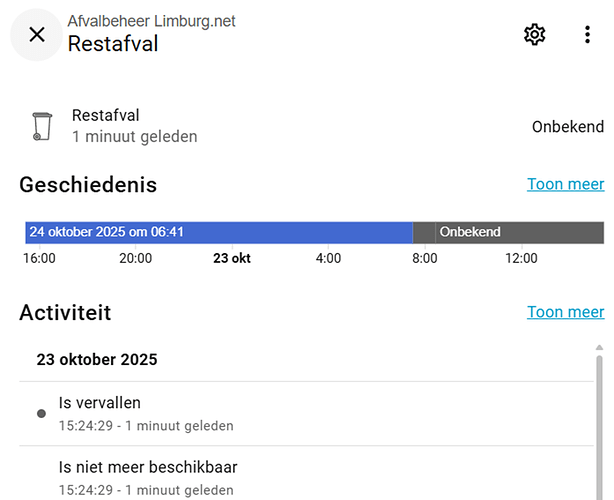

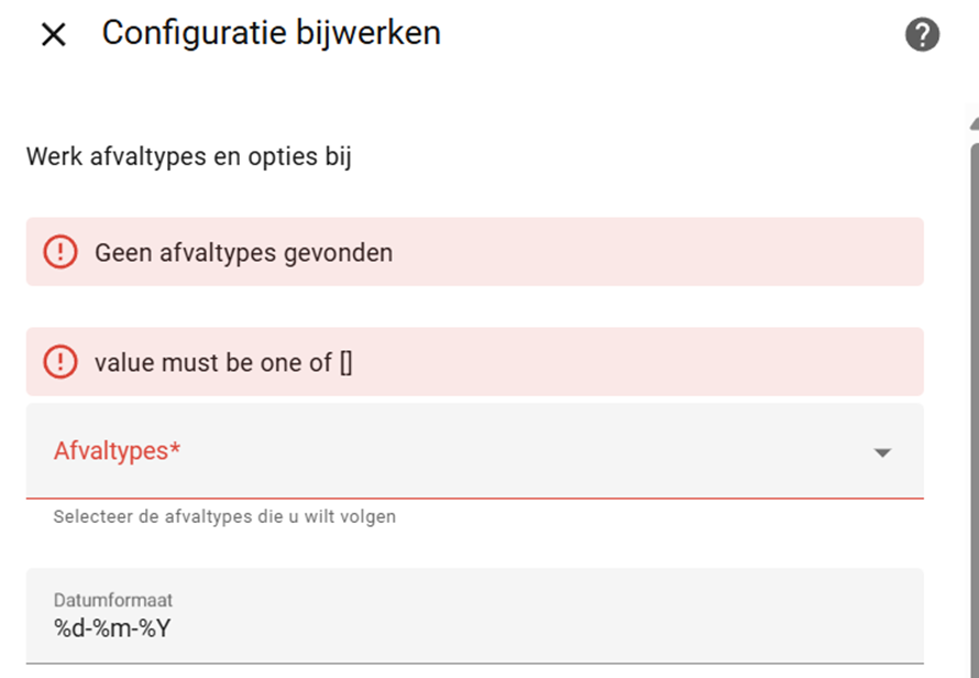

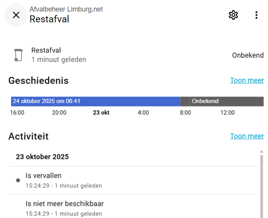

Does anyone experience issues with the Afvalbeheer currently?
Since yesterday my waste types are not calculated anymore. So I don’t know when the garbage collector (Limburg.NET) will come.
When I try to reconfigure the integration, I get this error:
So I am unable to complete the configuration wizard.
Does that mean the Limburg.Net API is down? I didn’t change anything on my setup.
