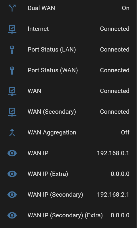

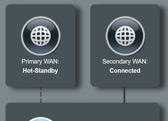

Hi all,
Sorry for a probably dumb question, but what’s the logic/reasoning to understand which one of WAN connection is active on a dual-wan setup when we have these sensor values?
This is from an Asus RT-AX59U with stock firmware 3.0.0.4.388_33965-g895dddb
I want to setup basic notifications based on WAN switching (failover/fallback) but can’t understand the sensor’s logic.
Maybe I can leave a small FR for this: A simple sensor that would hold one of 3 values for the active WAN: Primary, Secondary, None
Ideally however we would get the same info we get on Asus GUI for each port, i.e., Connected, Hot-Standby, Cold-Standby, Disconnected…
Many thanks in advance.

@jprates looks like we just need to use the attributes for existing entities…
sensor.gt_ax6000_wan
sensor.gt_ax6000_wan_secondary
they both have an attribute ‘primary’ … either true or false

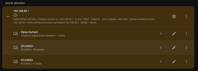

I’ve been having this issue for a while with both the AsusWRT and the AsusRouter integration.
Both fail to set up if i restart HA, only way to get them to work is to hard reset my router.
The integrations also seem to fail after a while.
I have searched everywhere for any suggestion on how to resolve this but i keep coming up empty.
I have tried several things to fix this, including setting different connection protocols (like HTTP/HTTPS etc) without any permanent fix.
