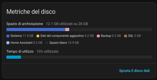

I’ve restarted it and now this is the situation:
My concern is how to see inside the 8GB of the custom component data (yellow bar) in order to understand the “memory hog”.
Question: can ESPHome sensor logging be mapped as custom component data? I’ve a luxmeter that provides lux data every 2s…

Found the root cause of 8GiB wasted space: it was caused by EspHome build environment that left a huge amount of files/data for previous build updates. Cleaning it and I restored a decent situation:
I hope that my experience could help someone.
