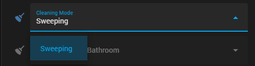

I have a L10s Ultra Gen2 and I have the latest beta version of the integration and it doesnt matter if i enabled custom cleaning or not my cleaning mode is limited to only “sweep”. Is this a error ?.. i read some posts and thought it should be to choose between the different modes at this state of the integration.
I saw some other already got it correctly implemented…
Please help :confused:
