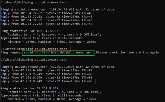

Pinging the de.iot.dreame.tech has no response from the server while cn.iot.dreame.tech & us.iot.dreame.tech works well. Maybe the problem is related to dreame servers.
Beta v2.0.0b19 worked well. Connected via Xiaomi Home Account (server DE).
Same issue since today: “Unable to login to device over cloud” with an X20+.
Guess it comes from Xiaomi side and hope it will be solved soon.
