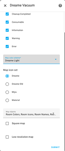

Does anyone know what are the two checkboxes at the bottom of the list for?
Square map is for rendering the map image 1:1 instead of its own ratio, useful if you have more than one map on your dashboard to be displayed at same height.
Low resolution map is for HA instances running on machines lower than 2GB memory.

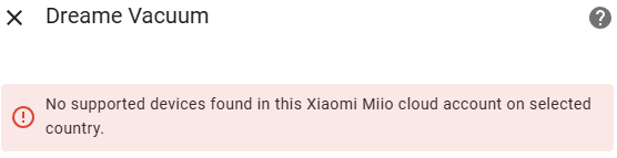

I would like to have my “Dreame X50 ultra complete” in HA, but seems this not (yet) compatible with the integration.
I tried V2.0.0B19 but got this
Any idea on a timeline :wink:

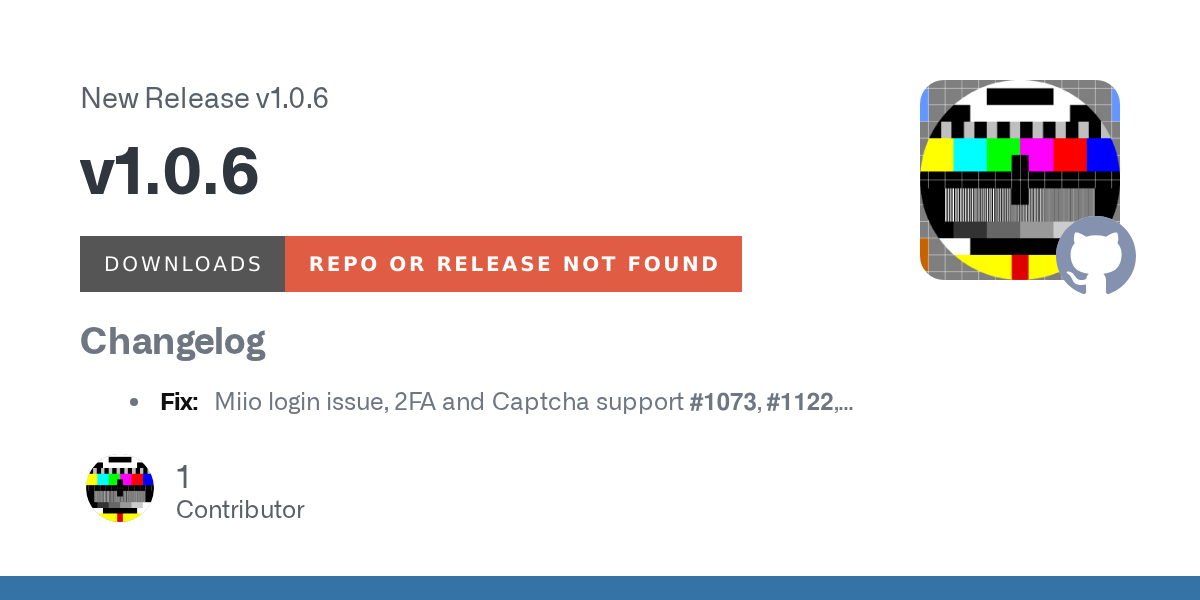

v1.0.6 has been released!
  • Xiaomi 2FA and Captcha support
  • Fix for deprecation warnings

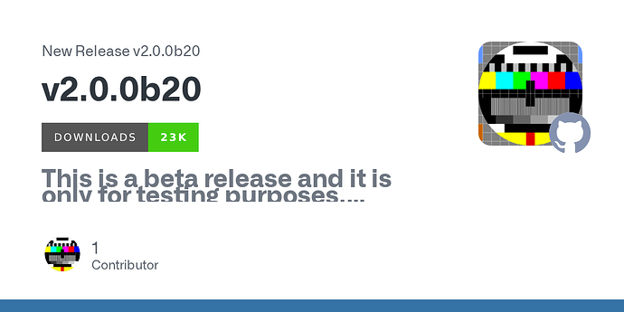

v2.0.0b20 has been released!
  • 50 new supported devices
  • Xiaomi Captcha support
  • Passable/Impassable threshold rendering
  • Curtain rendering
  • Ramp rendering
