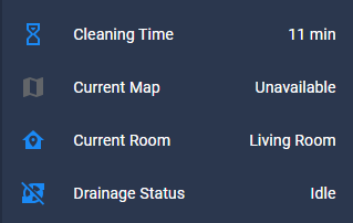

Hi guys,

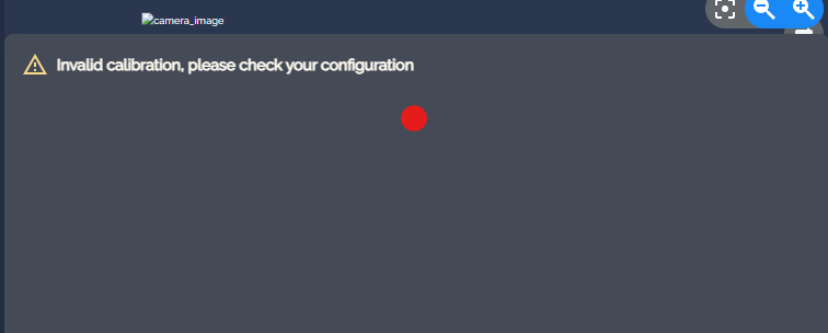

Something seems to be wrong with the map
It has worked in the past. But now I get unavailable for the map
I have deleted the integration and readded it and its still not picking it up.
I guess its only me or there would be many more people complaining about it to so confused as to what the issue is?
Thanks
IGNORE THIS, I didn’t realise I was stuck on an old beta. I wasn’t getting update notifications.
Fixed after manually updating

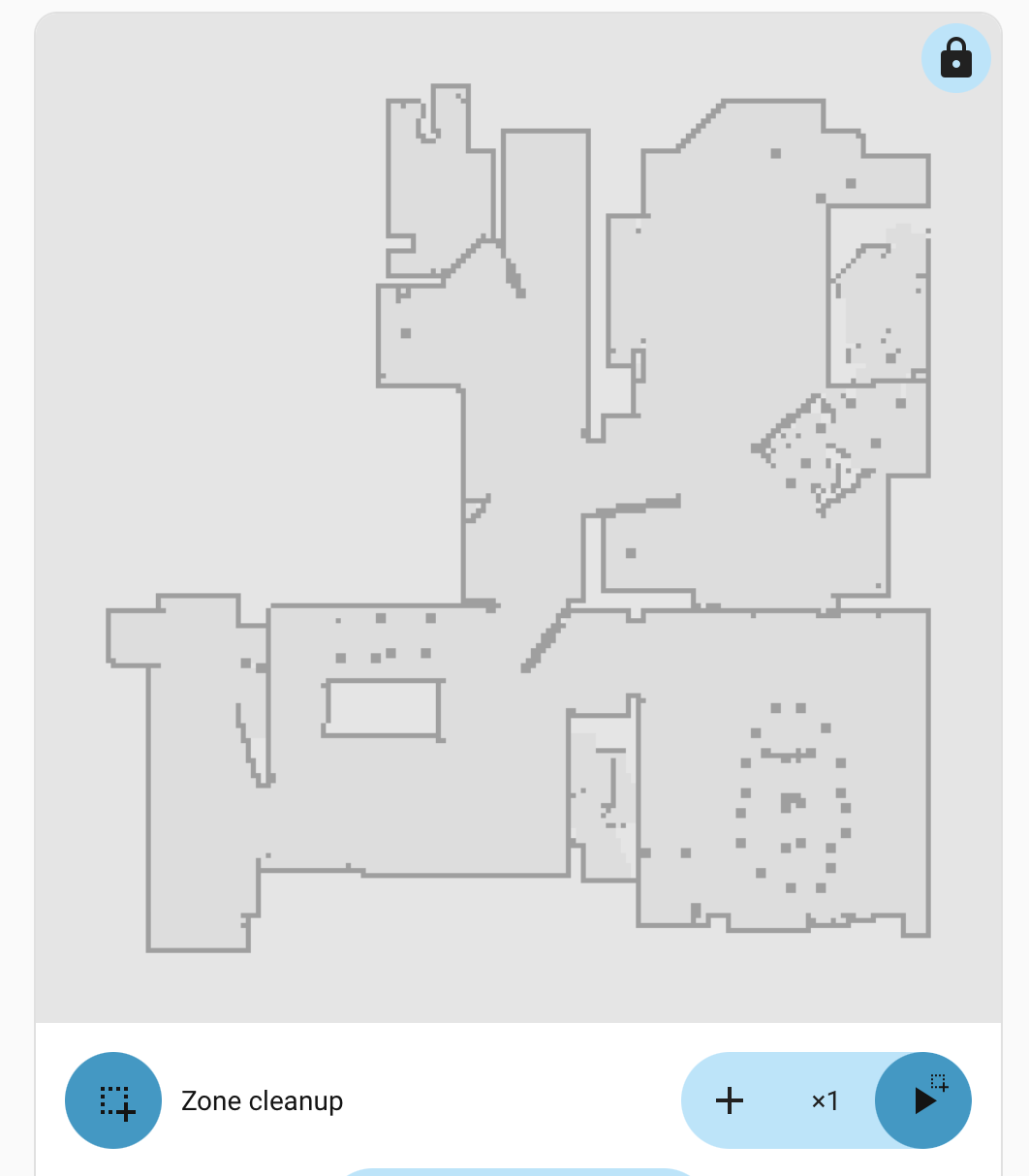

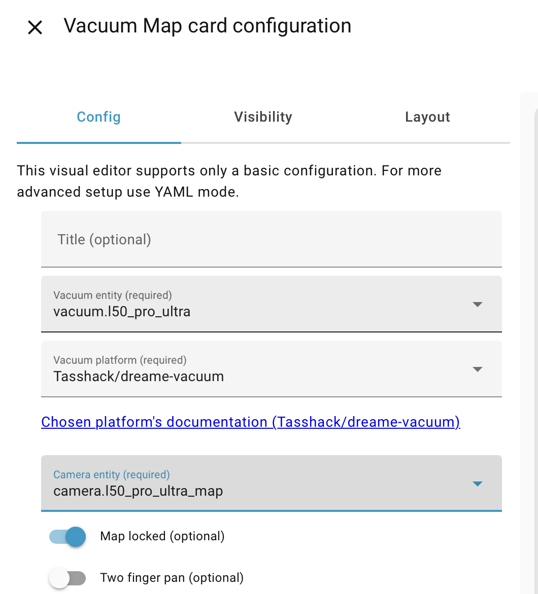

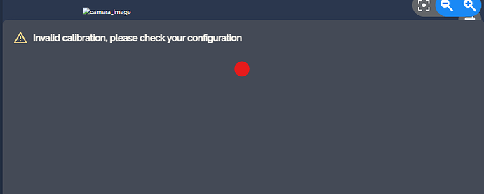

This integration is incredible. I can’t imagine how much time has been spent on it. I’ve donated but do seem to have an issue with the maps on my Dreame L50 pro ultra. I don’t see any of the info on the map only the room layout. Is this expected? I was hoping to see the vacuum location history route etc.

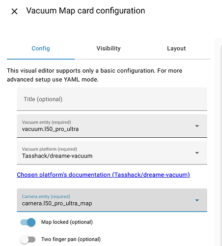

The Xiaomi vacuum card config is as follows

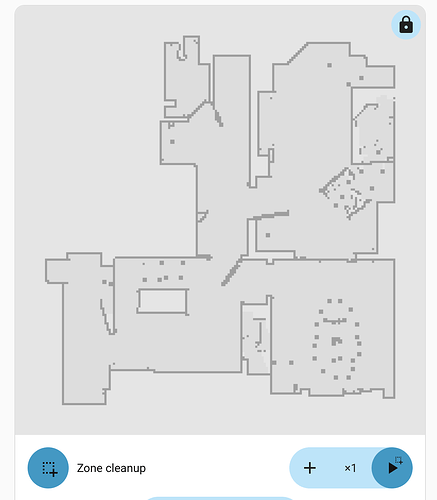

and this is what I see…
Thanks @tasshack !

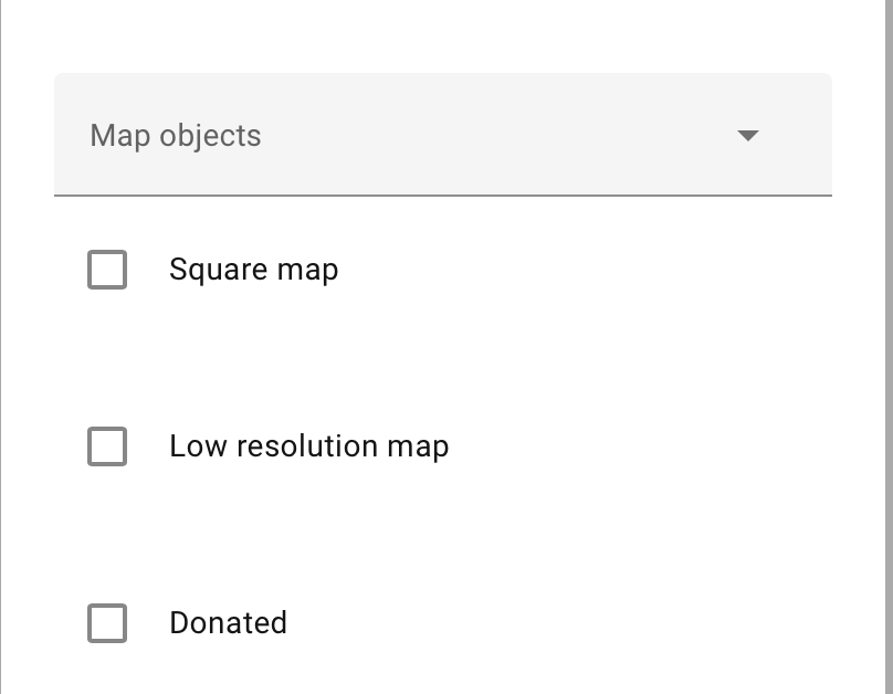

This is because of Hidden Map Objects from device configuration options.
Amazing, thank you. I had them all checked rather than unchecked as the setting is labelled map objects not hidden map objects.
I also had this, just realised I had selected ā€œGenerate Room Configā€ several times in the card configuration, I believe this imports your rooms list into that card configuration YAML. So, in edit YAML mode for your card, you need to scroll to the bottom and remove those repeat sections under " - template: vacuum_clean_segment", so you have just a single list of your rooms. Hope that helps.
