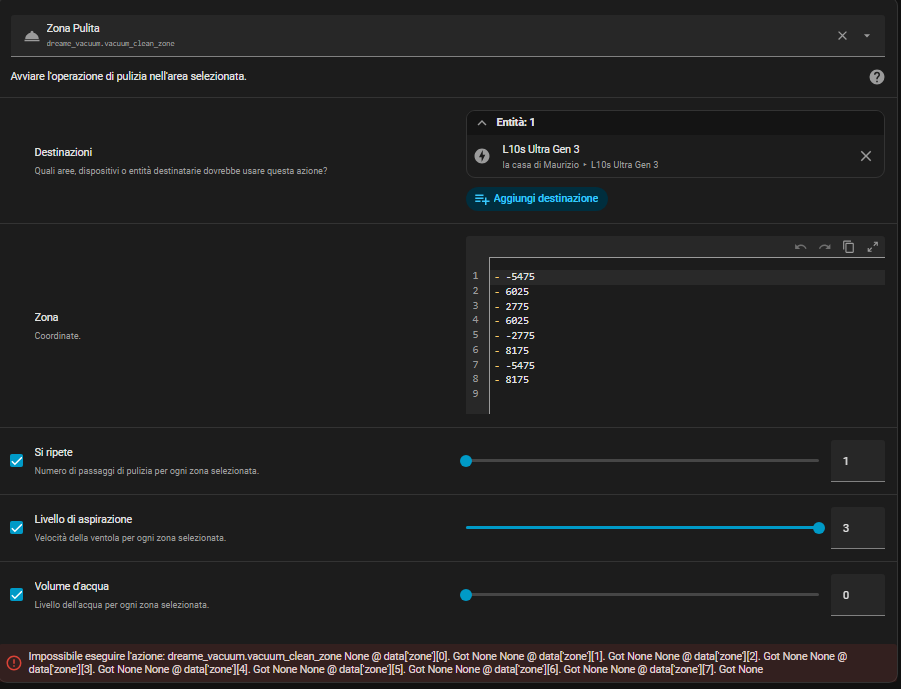

How to create predefined zones using this component and the xiaomi-vacuum card? I know i can create zones live with this card, but i will prefer to have predefined zones activable with a click. Is it possible? And if yes, How?
Thanks for any reply.
I am trying to save this zone and clean it, but get always the same error as you see in the screenshot.
Where am i wrong?
